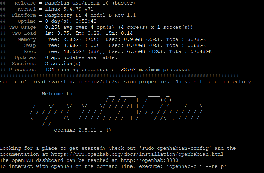

Also at the start i have still this page:

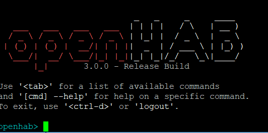

At the Karaf Console it has already changed:

Your login shell prints out some nice information when you log in. It’s looking for the version number of the installed openHAB in the wrong location now. I don’t know what file this is defined in, mayb .profile or .basrc in your home directory. Change the “openhab2” to “openhab”.
.bash_profile
I could tell you a gazillion ways to but fact is you don’t have to and probably don’t even want to get rid of them (to have them serve as a fallback or reference).
@rlkoshak
  1. Where is that file? :slight_smile:
  2. Are there more Openhab2 paths or only the two paths i mentioned before?
the file you want is ~/.bash_profile, like Markus said. He’s the expert, I just sorta know what’s going on with openHABian.
