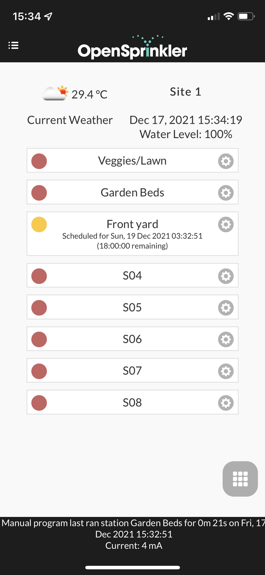

When checking the OpenSprinkler interface after this happened, I discovered a weird thing on the display: the stations weren’t all just on or off - they were in a “Scheduled” state (I’ve tried to attach a screenshot here, but it didn’t work - I might try in a reply).
After using the OpenSprinkler app to send a “stop all stations” command (returning them all to the normal “off” state), I could once again turn on individual stations through the OH interface, but as soon as I triggered the rule at the start of this post, I got the OFF->ON->OFF behaviour again, along with the “Scheduled” state in the OpenSprinkler interface.

As you can see, the “scheduled” status is for a time roughly 36 hours in the future.
I should also point out that there are no “scheduled” programs at all in the OpenSprinkler, except for the daily reboot schedule (the current workaround for OpenSprinkler’s tendency to drop off the wifi network at random intervals)

  7. The 18 hour delay makes me think this may be a timezone mismatch as it should queue up the station and start when the other one finally recognizes as being stopped.

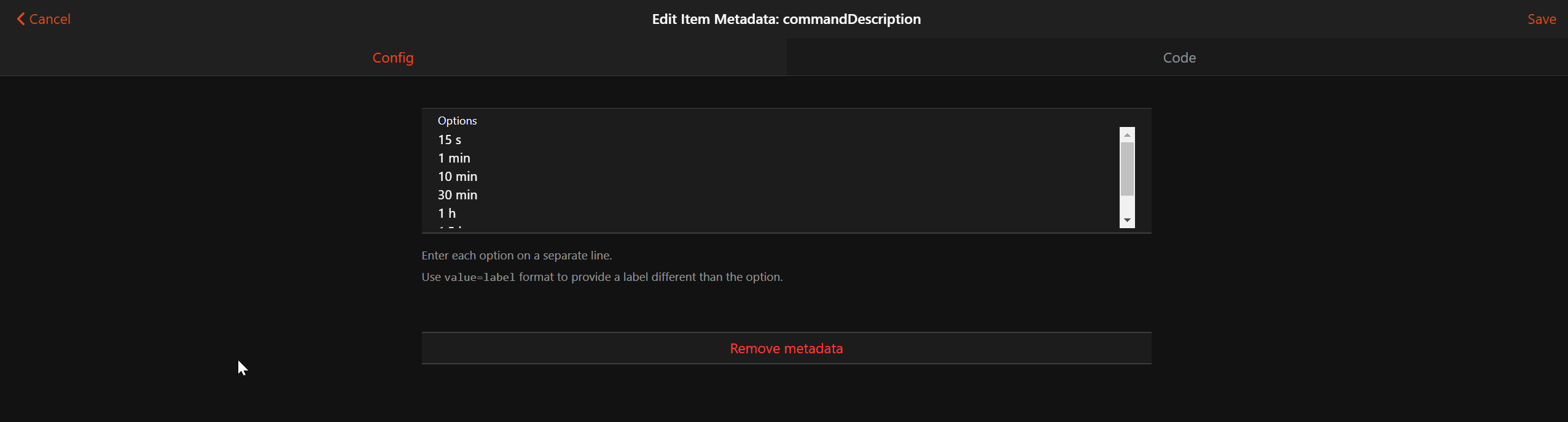

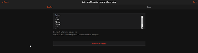

BTW if you want a nice drop down list of durations add METADATA and STATE OPTIONS
