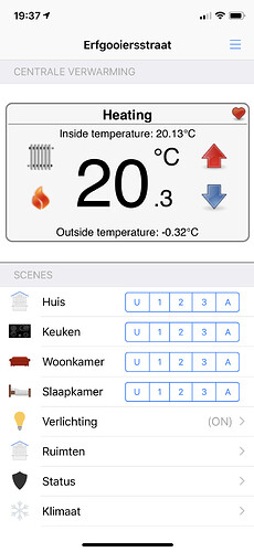

I had the same problem. 0.8 fixed this indeed! I am very happy with the binding! The outside temperature is spot on again.
kr Han

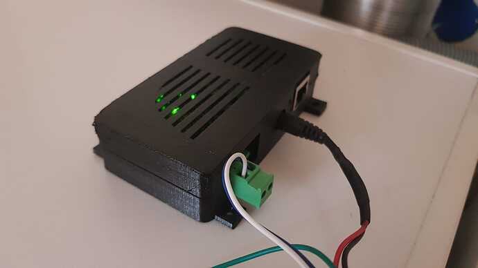

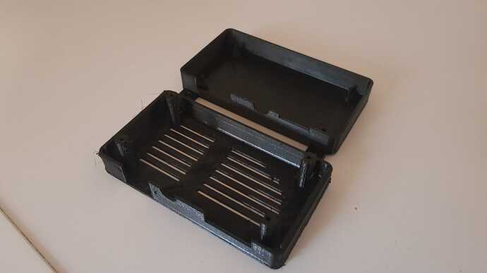

Hi All,
I’m still very pleased with the binding and it is working great.
Because of the lack of a case supporting the LAN add-on on the OTGW board i designed a 3d case for the SMD OTGW (first real 3d project so not perfect, but it fits very good). If someone is interested in the drawing I can create the STL file and share it.
Reg,
Mic
edit: I have uploaded the case design to Thingiverse it will be visible after 24 hours:
