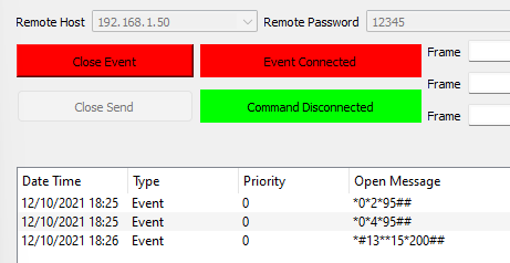

also i don’t know if can help:
There are no traces of CEN/CEN+ messages also in the new log.
From the openwebnet client I can see *0*2*95## and *0*4*95##: what these two tell you?
Have you these configured somewhere in the panel/Bticino configuration? They are related to scenario (but not CEN/CEN+ scenarios) with address where=95

Yes this 0295## and 0495## are called from two scenarios buttons on the wall.
From 1 to 4 are physical and from 5 to 16 virtually configured from my lcd…
Some minutes early of that you can see 01*95## that opened all my rollershutters.

i think this can help you, but for me ould be a bad news:(
2021-10-13 09:02:08.815 [INFO ] [unication.BUSConnector.message.event] - BUS-MON <<<<<<<< *0*4*95##
2021-10-13 09:02:08.816 [DEBUG] [nwebnet4j.communication.BUSConnector] - UNSUPPORTED FRAME: *0*4*95##, skipping it
what does this mean?
who=0 older scenario scheduler (i.e. messages starting with *0*) is in fact not supported yet.
