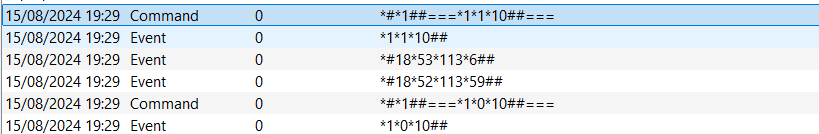

The ones that are not working properly are the ones with WHERE between “01” and “10”.
I have two different types of errors:
  1. WHERE=“01” to “09” the error is “Could not get get channel state”
  2. WHERE=10 error is “OpenWebNet Address (where) parameter in configuration is null or invalid”
    From bTicino application H+C everything works properly.
Error 1:
From OH I can command the switches (turn on/off the light works), but the status in OH is not updated.
Here’s the log:
2024-08-15 19:39:42.297 [INFO ] [openhab.event.ItemCommandEvent      ] - Item 'bs03' received command ON

Error 2:
I cannot send the command to turn the lights ON opr OFF.
Tested with the OpenWebNet Client sending the command manually and all is working (example with WHERE=10):
So the light is properly addressed and working using WHERE=10, but when I try to send the command with OH4 it gives the following error and do not command the light:
2024-08-15 19:37:25.292 [INFO ] [openhab.event.ItemCommandEvent      ] - Item 'bs18' received command ON
2024-08-15 19:37:25.293 [INFO ] [penhab.event.ItemStatePredictedEvent] - Item 'bs18' predicted to become NULL
2024-08-15 19:37:25.295 [DEBUG] [ernal.handler.OpenWebNetThingHandler] - handleCommand() (command=ON - channel=openwebnet:bus_on_off_switch:mybridge:s18:switch)
2024-08-15 19:37:25.295 [INFO ] [ernal.handler.OpenWebNetThingHandler] - Cannot handle ON command for openwebnet:bus_on_off_switch:mybridge:s18: 'where' parameter is not configured or is invalid
2024-08-15 19:37:26.943 [TRACE] [rnal.handler.OpenWebNetBridgeHandler] - RECEIVED <<<<< `*#18*54*113*180##`
2024-08-15 19:37:26.943 [DEBUG] [rnal.handler.OpenWebNetBridgeHandler] - ownIdFromMessage(`*#18*54*113*180##`) --> 18.54
I tried to reset the MHS1 and all the actuators rebuilding the system from zero, but I still get the same problem.
Any idea of what it could be?
