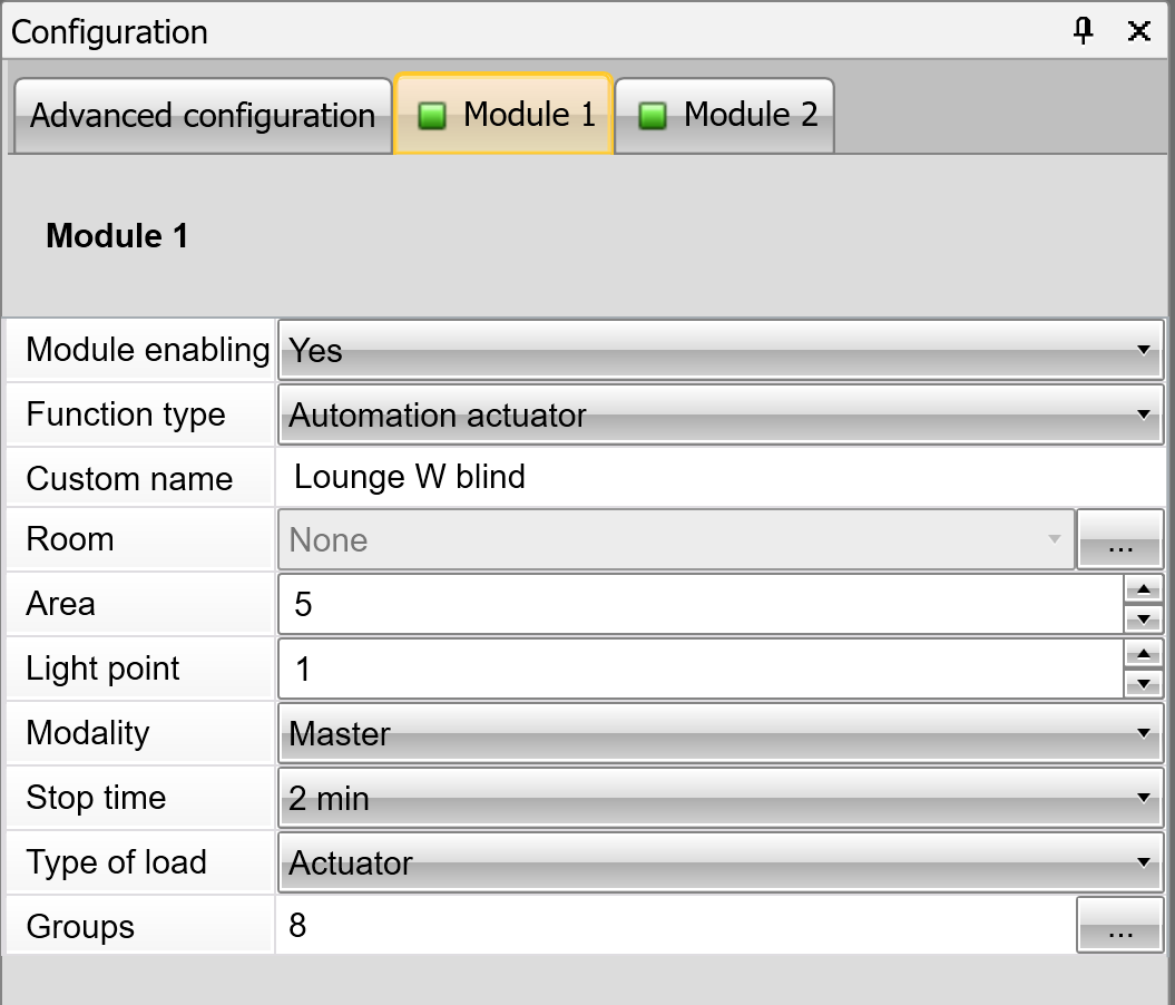

@massi, could this be the cause of the shutter going to UNDEF when issuing the command after reboot?

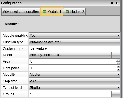

as you see at @m4rk myhome config, he set the actor to 2 min. standard this is always set to 60sec - so i suppose this could be the reason for your problem.

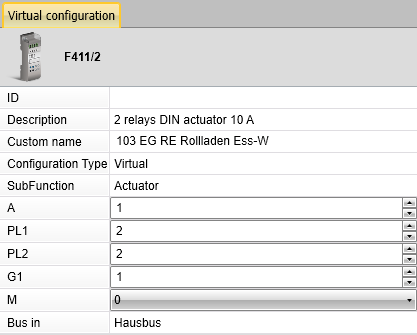

i set all shutter actors in myhomesuite 2 seconds longer as in oh - to prevent that actor stops before oh. at least for me the setting in mhs is not so important because if set for example to 60sec the actor always is on for 60 sec, even if the shutter was nearly open and works only for 10 sec.
so one example of me:
mhs:
and corresponding setting in things-file:
bus_automation                Balkon_Ro                   "Balkon_Ro"                     @ "Rollladen"   [ where="91#4#01", shutterRun="26000" ]

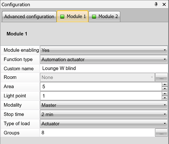

It was a long time ago but I think I set all my blinds at 2min for the auto stop to avoid ‘issues’ like you are seeing. 2min because that is longer than the max runtime of my longest blind and as far as I know it is a safety stop. The stop event seemed to be necessary to get the binding to update. I even add extra stops in scenarios for by wireless blinds.
correct, i also think a longer time set in the actor (mhs) is not a problem, but if shorter the binding gets confused.

Oh, and I should correct myself. I don’t have 2mins for all my blinds. It seems I started to put more realistic times for the configured autostop but not for all blinds. About 2 secs longer than shutter run.

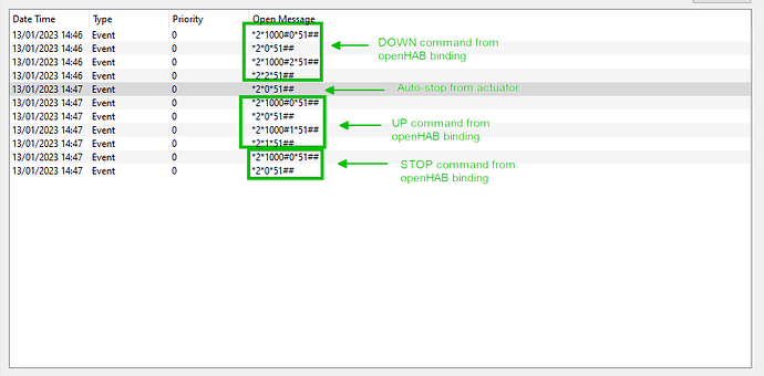

Do the two stops look the same on the BUS? The binding seems to treat them differently. sitemap stop vs autostop

I was thinking about why the different binding reaction to autostop vs rule, sitemap stop. I assume the frames are the same.
I already pointed this out but got no comment. Could it be that autostop and possibly wall switch stop are sent on the bus and are only received by the binding. Whereas, rule and sitemap stops are sent via the binding. So the difference is the direction, the binding is either sending or receiving the stop commands and therefore reacts differently.
I don’t know about that either, so far I did not try sending stop messages from OH.
Did you try to look at the frames with the OWN client?
No I didn’t dig any deeper. I actually dont have an issue with it as it is as I found ways to make it work a long time ago.
I gave it a try and to me the stop message from the actuator looks the same as those triggered by the openHAB binding. See the screenshot below. I would guess the difference that leads to the issue is more with the state the shutter is in in openHAB than anything happening on the bus.
I am not a expert in interpreting the frames but auto stop looks different. Your results confirm what I supsected. For up or down the binding first sends a stop and in the case of consecutive up/down commands it shows the position after the first command but for the actual first command it shows the target position 0/100, assumimg the UNDEF has gone away.. Not that it matters much for me.
