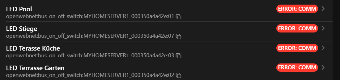

i have some strange problems since i upgraded to OH 4.2.
First - Automation for some specific addresses stopped working. I have one rollershutter with adress 80 - this does not work anymore - see log below - 80 is an invalid address?
Second - seems like all on/off switches (lights) with address 00 to 09 do not work anymore.
They can be switched on and off - but the status remains offline:

i am on oh 4.2.0 release buld and i do not have this problems. surely because i do not use pl=0 at all. and if i read the error message that you posted there also is suggested not to use zero for pl.
same with amb, i think you must not start with 0 but begin with 1
if i read the docu correct it right it could work with amb 0 if you note it as 00 but i did never test. and even if, the pl always begins at 1
oh - this is interessting - my electrican installed the hous years ago - and i never had any problem with it. but seems you are right - reading the openwebnet docu it says below. think i will adopt my addresses!
thank you

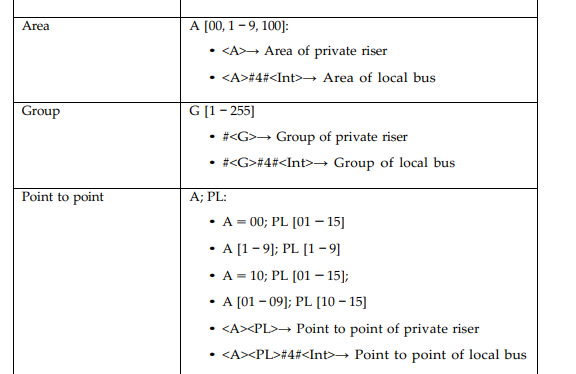

Yes @noxe : starting with 4.2 the binding has a stronger check for configured addresses and as you and @bastler have pointed out the one in your current configuration are not compliant with the Specs.
The only accepted formats are those in the image you published
What is really strange is that the SCS bus, actuators and controllers and the BTicino gateway itself accept a configuration with addresses that are not correct!
Yes the best solution IMHO is to reconfigure those addresses to the correct version

@geoborders : According to the official BTicino documents these are invalid WHERE addresses.
Can you change these addresses in your system?
