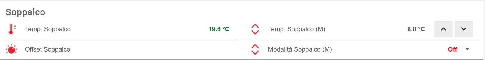

It seems to me that the binding is working as expected. I can change the setpoint temperatures in “Manual” mode and the binding and the thermo-zone are always aligned (checked with an F454 gateway). When I put a thermo-zone in “Auto” mode from OFF or Protection, the behavior is the one expected: the mode in the binding is changed to “Manual” and the corresponding setpoint temperature is set to the last one associated to the themo-zone (the one associated to the auto mode or manual mode, according to the last configuration of the themo-zone itself). This is the same behavior you can experience using an F454 gateway. The only two comments I have (but actually I don’t know if already covered by the current development, so in case please ignore them) are:
  • Thermo-zone in Protection mode: the setpoint temperature in the binding is not updated to 7 degree (see following figures).
  • Thermo-zone in Off mode: the setpoint temperature in the binding is not empty (see following figures).
In both cases the setpoint temperatures continue to point to the last setpoint temperature (manual or auto) associated to the thermo-zone (8 degree in the following figures, “Temp. Soppalco (M)” field).
