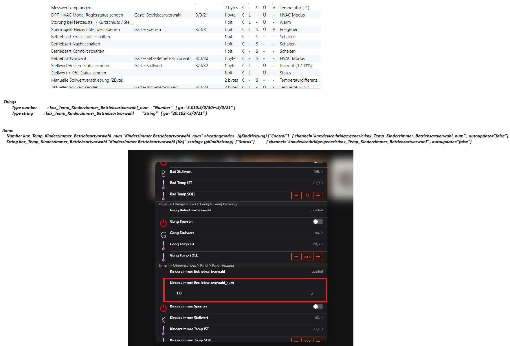

I use openhab 3.4.5 main UI, knx mdt AKH0800.03 and I assigned the values to the equipment in the main UI.
I see the status string of the operating mode and I am able to control/see the mode about a number value.
I want to use only one item, is it possible to map the number value to an string (“Kinderzimmer Betriebsartvorwahl_num”). I tried it with MAP Transformer Binding, but I didn’t see the string.
Tried Mapping:
1=Komfort
2=Standby
1.0=Komfort
2.0=Standby
1,0=Komfort
2,0=Standby
at a page with label widget the transform mapping works. Does the transform map work in the equipments at semantic model?
