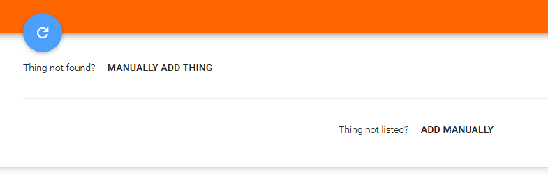

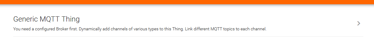

    After klicking on “add manually” I see following:
    You need a configured Broker first. Dynamically add channels of various types to this Thing. Link different MQTT topics to each channel.

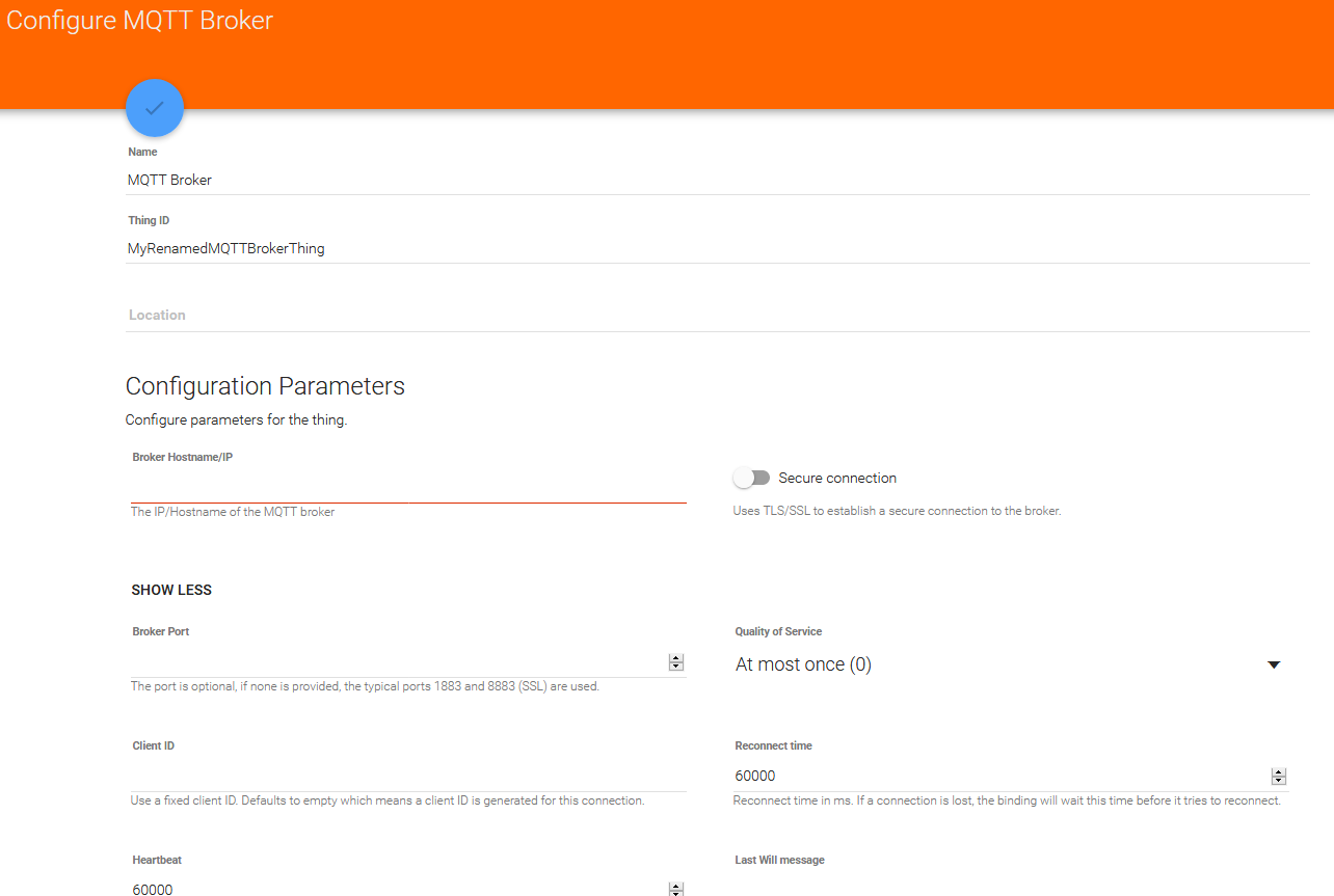

Thank you, but if i have both, why openhab tells me to configure a broker?

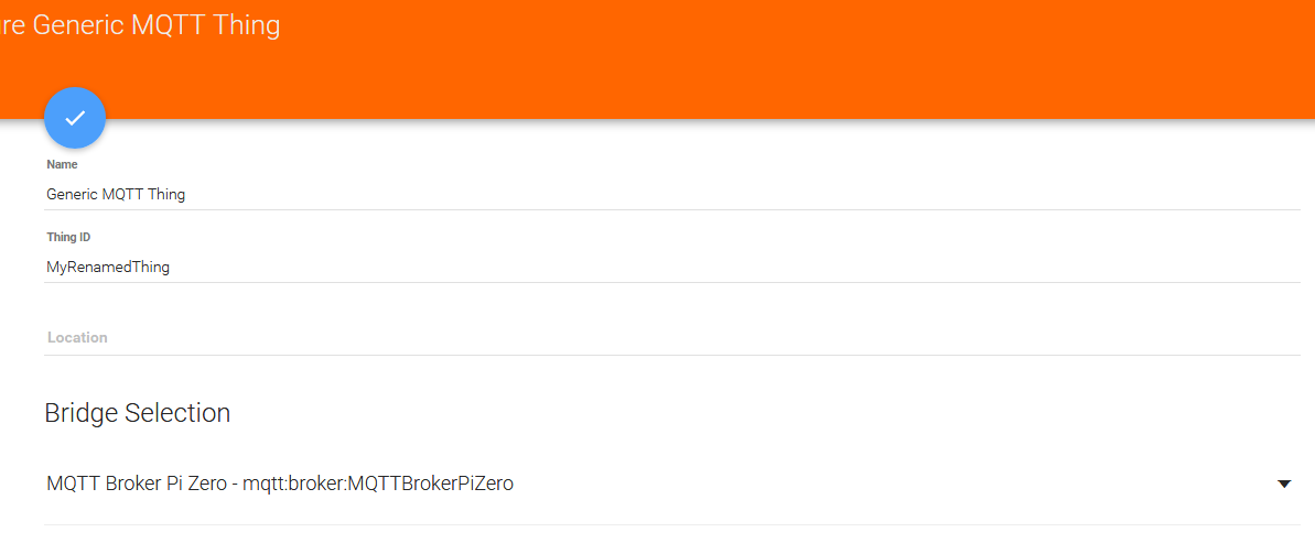

You need to tell openHAB which broker to use for this thing:
As you see I have renamed the Generic MQTT Thing
And chosen a broker Thing for it to use

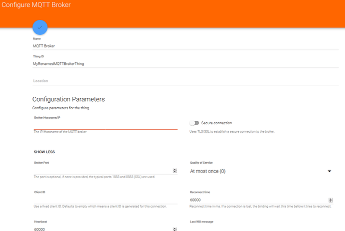

So You must first configure a broker MQTT thing:
Again, I have renamed the thing to something more human and clicked the SHOW MORE button
