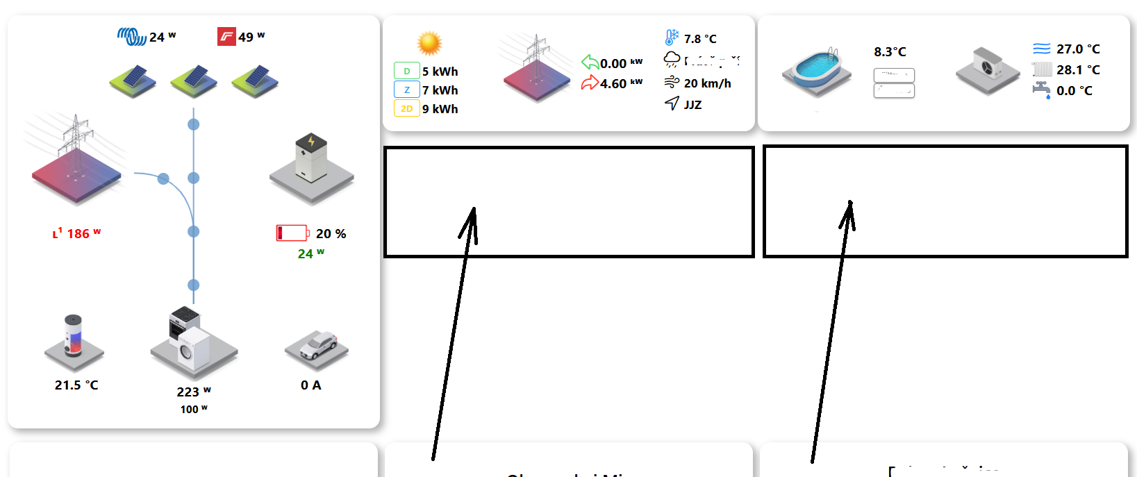

I want ask, if is possible change a overview page layout that my widgets are all together = No free space ? See my picture :
It’s PC problem, on the cell phone it’s ok, widgets are in one column.
You can do this, but you will have to manually edit the page yaml.
