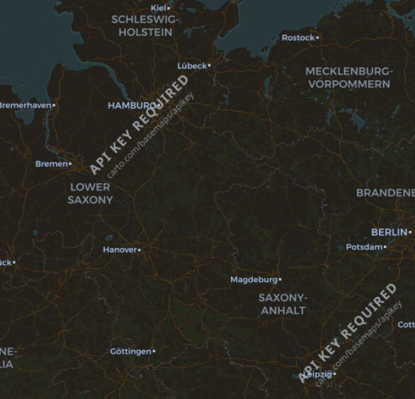

recently my map on a page (component: oh-map-page) on which I display locations of cars and people comes up with the information “API KEY REQUIRED - carto.com/basemap/apikey”. The link says, the API key is free of charge.
but: I don’t seem to find the configuration page for that? Is there a way to place an API key somewhere?

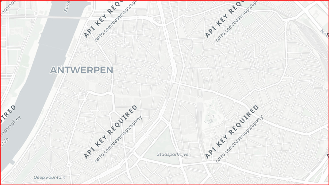

But just to grasp how it works, I wanted to test the API key with CartoDB. I still can’t get it to work:
  icon: ""
  initialCenter: <lat>, <lon>
  initialZoom: "15"
  tileLayerProvider: CartoDB
  tileLayerProviderOptions:
    apikey: <APIKEY>
  overlayTileLayerProvider: CartoDB
  overlayTileLayerProviderOptions:
    apikey: <APIKEY>

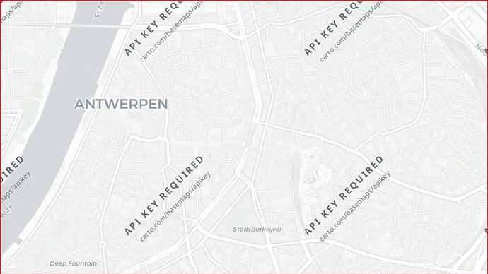

This still complains:
