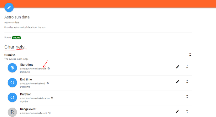

Things provide “Channels”, which represent the different functions the Thing provides. Where the Thing is the physical entity or source of information, the Channel is a concrete function from this Thing. A physical light bulb might have a color temperature Channel and a color Channel, both providing functionality of the one light bulb Thing to the system. For sources of information the Thing might be the local weather with information from a web service with different Channels like temperature, pressure and humidity.
Channels are linked to Items, where such links are the glue between the virtual and the physical layer. Once such a link is established, a Thing reacts on events sent for an item that is linked to one of its Channels. Likewise, it actively sends out events for Items linked to its Channels.

If I click on either of the thinks I can see the channel.
So now I assume I need to select configuration - items and add.
