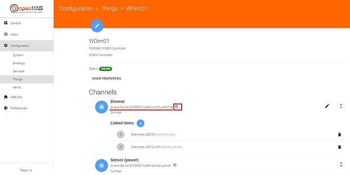

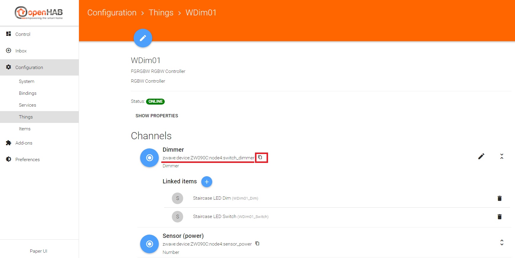

To find the correct channel name of a thing to be used for the item definition, use PaperUI → Configuration → Things. You can copy the name from there and paste in in your `{ channel =“” } section.
Example (Z-Wave but not Z-Way …I believe that it’s similar) bound Items for the PaperUI channel shown in the screenshot below:
Dimmer	WDim01_Dim			"Staircase LED Dim [%d %%]"	<slider>	(gZWave,GF_P02_Corridor)    {channel="zwave:device:ZW090C:node4:switch_dimmer"}
Switch  WDim01_Switch		"Staircase LED Switch"		<switch>	(gZWave,GF_P02_Corridor)	{channel="zwave:device:ZW090C:node4:switch_dimmer"}
