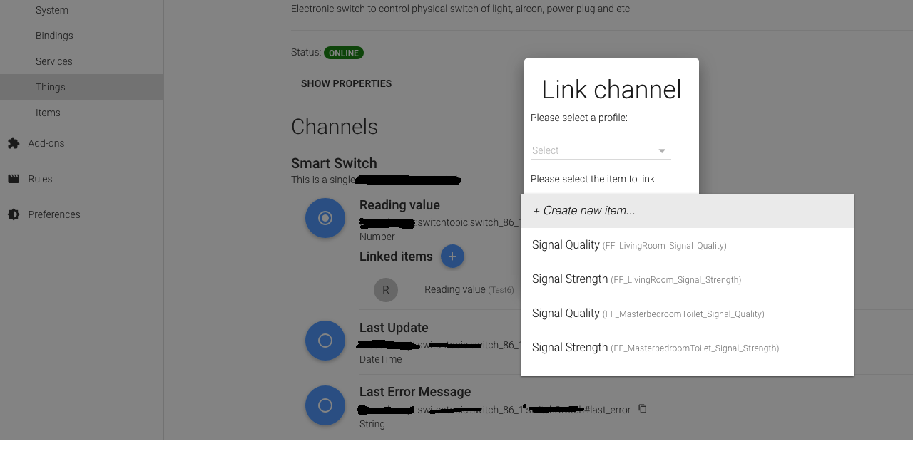

Anybody encounter this issue? I saw it on 2.3 and 2.4 stable. Basically, the problem is if you navigate to Things from PaperUI and then try to link an existing item to a particular thing. If there are 30-40 or more (i didn’t count) existing items, many of those items are missing from the dropdown list. Is this a bug or as per designed? See picture attached. Thanks
Are you sure the item-type is compatible to the channel? If not, those channels do not show up.
