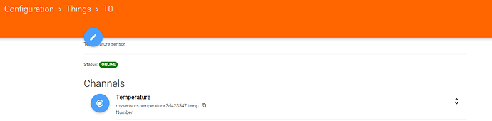

I have a problem with setup any other type channels! My OpenHAB have this channel:
Here is PaperUI without form topic like “generic/foo/bar/{state,command}”
What settings(MQTT state topic,MQTT command topic) need to be set in “master” and “slave” instances?
How can I set a link to my existing channel?

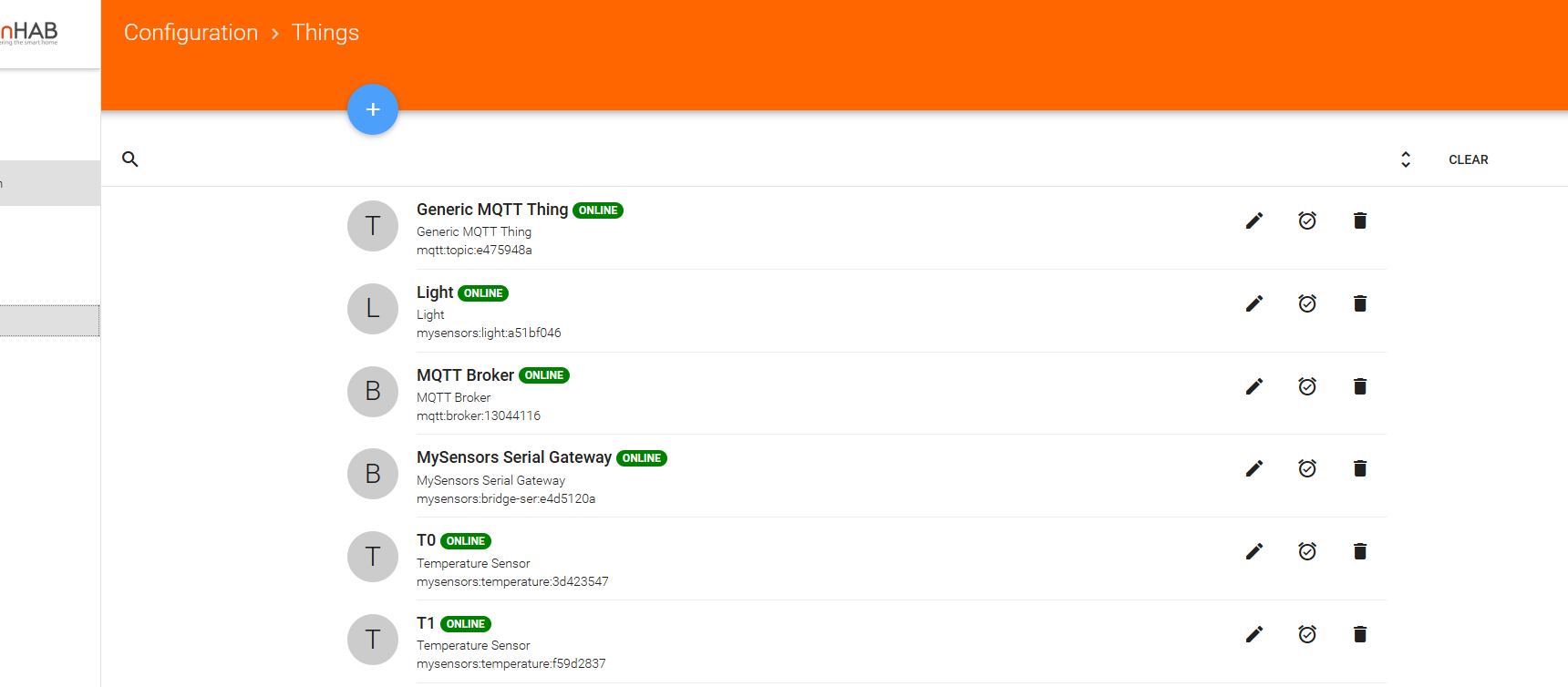

This is my Openhab Things

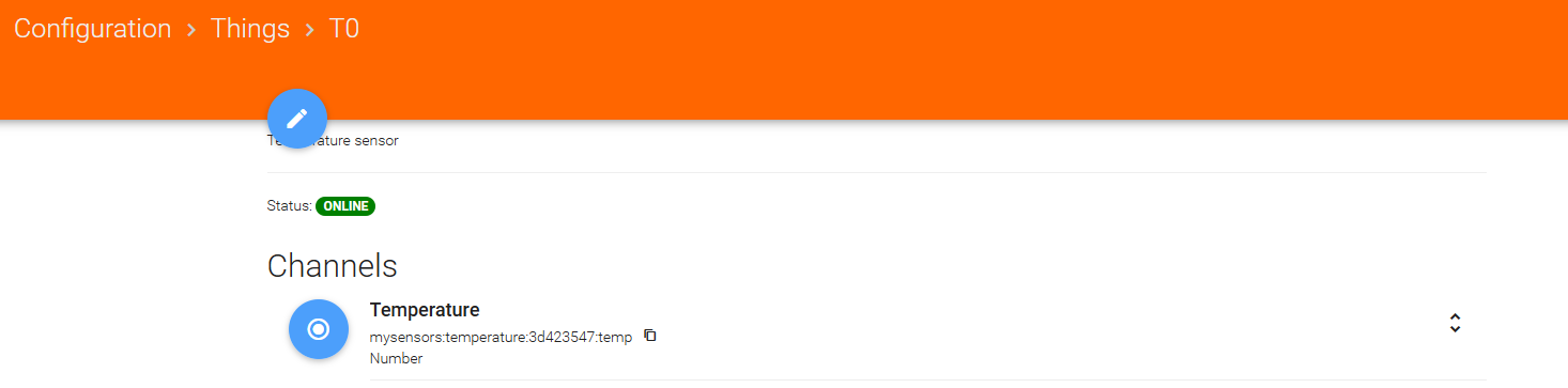

There are two bindings: MySensors and MQTT Binding.
I want to create link in Generic MQTT Thing to Arduino sensors from MySensors and don’t know how (
Your mqtt looks correct as I see the broker and a generic mqtt thing. Did you look at the link posted by Rich above?
