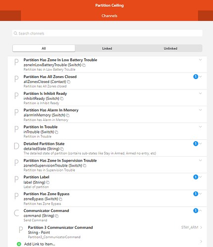

I am referring to the ITEM linked to the Command CHANNEL on the Partition THING (the ITEM must be a STRING):
label: Partition 3 Communicator Command
type: String
category: ""
groupNames:
  - Partition3
groupType: None
function: null
tags:
  - Point
I also think part of the issue is the oh-toggle, I did a quick test and it did not work, but works fine with an oh-button, the following works on my system:
uid: Test3
tags: []
props:
  parameters:
    - description: A text prop
      label: Prop 1
      required: false
      type: TEXT
    - context: item
      description: An item to control
      label: Item
      required: false
      type: TEXT
  parameterGroups: []
timestamp: Sep 7, 2023, 2:22:15 PM
component: oh-button
  action: command
  actionCommand: STAY_ARM
  actionItem: Partition3_CommunicatorCommand
  text: STAY

Is the ITEM correctly linked to the CHANNEL?
Also not sure is the setting below is required for ARM?
I think so, see attached
