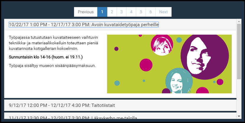

Note how I lazy-loaded the controller on the first line, assigned it to the inner part of the widget using ng-controller
, and leveraged ui-bootstrap’s pagination control to do the heavy lifting for the paging stuff and accordions with ng-repeat="event in events"
to present the data in a fancy list. The ng-change="loadData()"
on the pagination control ensures the data for the appropriate page is retrieved from the API when the page is changed.
The end result after less than one hour is what you’d expect and may not be exactly what you want, but it’s a start:
