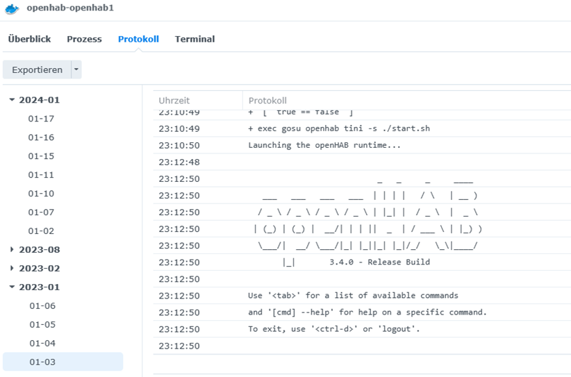

I thought i might be in another type of console which is probably not Karaf so i checked the logs and found:
This looks like the Karaf console. I read here that the pasword for the console is stored in /openhab/userdata/etc/users.properties. I found the encrypted version of the password:
