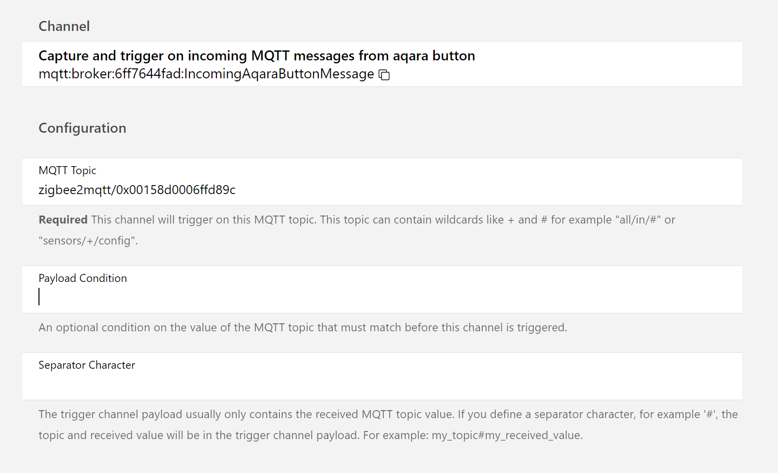

Hello all,
Trying to configured a channel trigger on the mqtt broker so that it triggers when a specific event is received
The event that needs to serve as a trigger is a single push of a zigbee button coming through MQTT
Here is the message
'zigbee2mqtt/0x00158d0006ffd89c', payload '{"action":"single","battery":100,"click":"single","linkquality":30,"voltage":3145}'
In the trigger channel screen I don’t know how to capture the “action”:“single” value from the payload. I believe the payload condition seems to be a fit however I am not sure what to put in there. I tried single, action:single but nothing worked
The trigger works when I only put the topic as shown below

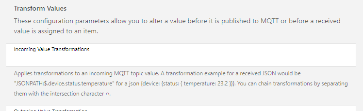

Open the Advanced options, then scroll down to “Transform Values”.
As you can see in the example, you can apply a JSONPATH transformation to the incoming message (you’ll need to install JSONPATH if you haven’t already done so).
This will isolate “single” as the incoming message, which you can then use in the payload to trigger the switch. However, I haven’t personally tested if that works.
Hello Russ,
There is no advanced options in the MQTT broker channel trigger page as you see in my screenshot. This is when you configured a trigger channel on a thing. I can see the transformations there but I don’t see how can this capture the signle condition I want to trigger channel to use which is “action”:“single” in the payload.
As far as I understand this is just to modify the incoming payload to something else
Any ideas ?

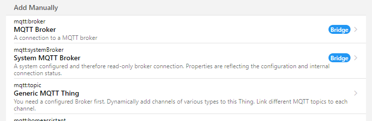

Hang on, are you trying to add a channel to the broker? If so, that’s not how it works.
The MQTT broker is just there to serve as a bridge and provide the connection. Once you’ve set it up, you need to add a Generic MQTT THing for your specific device.
That’s where you’ll add channels.

Do as @rpwong says, create a Generic topic Thing and set up a channel with any transformation you like. Use trigger option to make it generate an openHAB event instead of the usual Item update.

Actually you can add Channels to the Broker. You would do so in just this case, where you want to trigger an event (think the Astro event Channels) instead of link it to an Item.
You need to add a Separator Character, something like “#”. Then in your rule that triggers from the channel you can get both the topic and the message using event.event. That will be a String <topic>#<message> so you can split that String to get at the message.
Unfortunately there is no way to transform the message in this type of Channel so you’ll have to parse that payload message in a rule. If the message were always the same you could use the Payload Condition but I see a battery level as part of the message and that will change over time.
