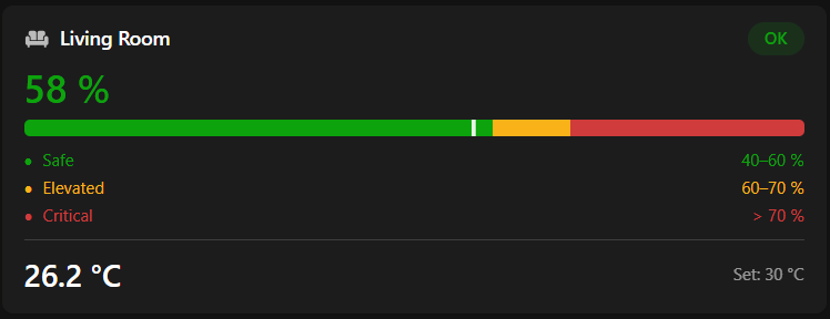

A compact card showing a room’s current humidity with a colour-coded status badge, a zone bar visualising the safe/elevated/critical thresholds, and the current temperature and thermostat setpoint.
Features:
  • OK / Elevated / Critical badge — colour-coded green/amber/red based on configurable thresholds
  • Large humidity value — colour matches the badge
  • Zone bar — CSS gradient bar with a live position indicator showing where the current reading falls
  • Three-row legend — Safe · Elevated · Critical with the configured percentage ranges
  • Temperature + setpoint — shown below a divider; tap the card opens the Analyzer for both items
Thresholds are fully configurable via props (default: safe < 60 %, elevated 60–70 %, critical > 70 %).

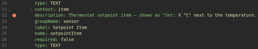

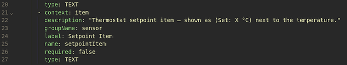

  • Fix: YAML parse error in setpointItem description (: inside an unquoted scalar misread as a YAML mapping separator) — description now single-quoted

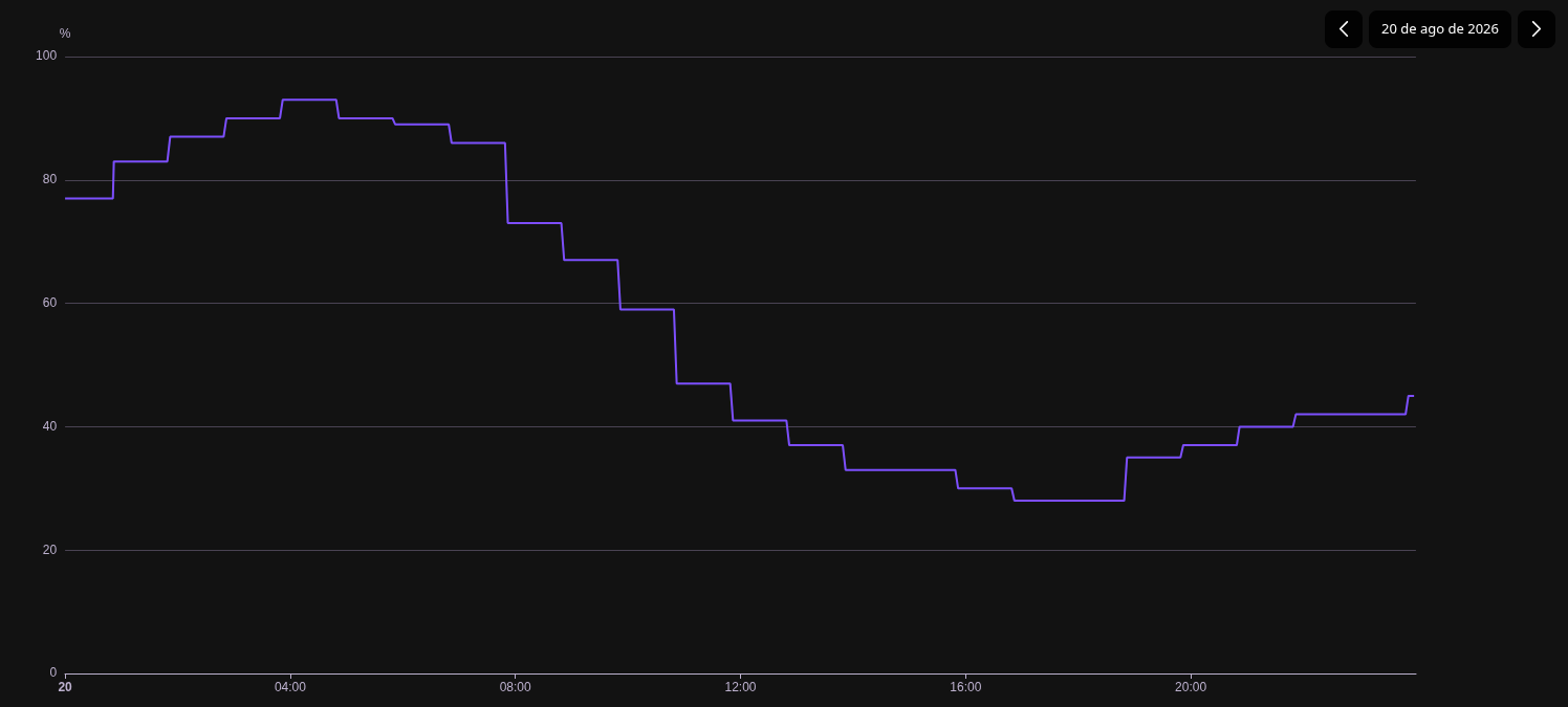

Outdoor humidity levels can vary significantly across different parts of the world.
Below is an example (from August 20th) of the outdoor humidity levels in my area.
That is why I mentioned having four alert bands.
