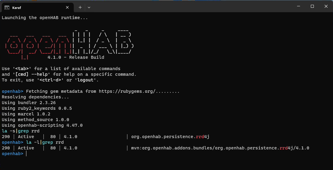

@splatch OK, thanks. It seems that rrdj4 v. 4.1.0 is active.
The rrd4j library is embedded into rrd4j persistence. By checking sources I found that OH <= 3.4.5 used rrd4j in version 3.8.1. OH >= 4.0 uses rrd4j version 3.8.2.
However, looking at changes between these two versions of rrd4j library I see no reasons for change in behavior. Hence rrd4j itself is unlikely to be guilty of performance issues you face.

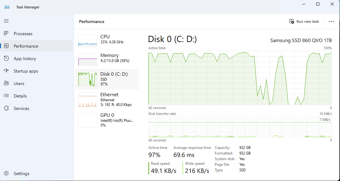

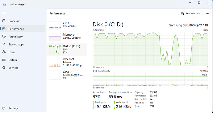

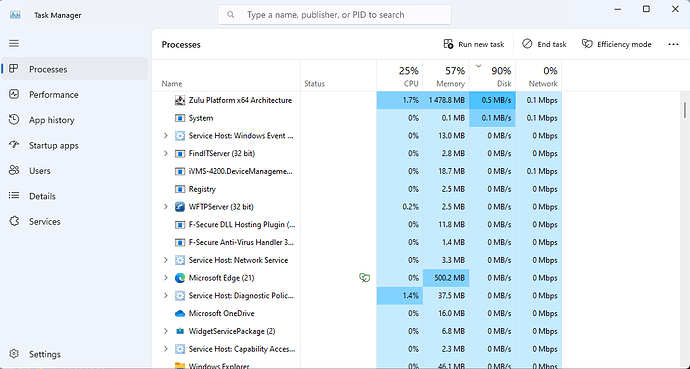

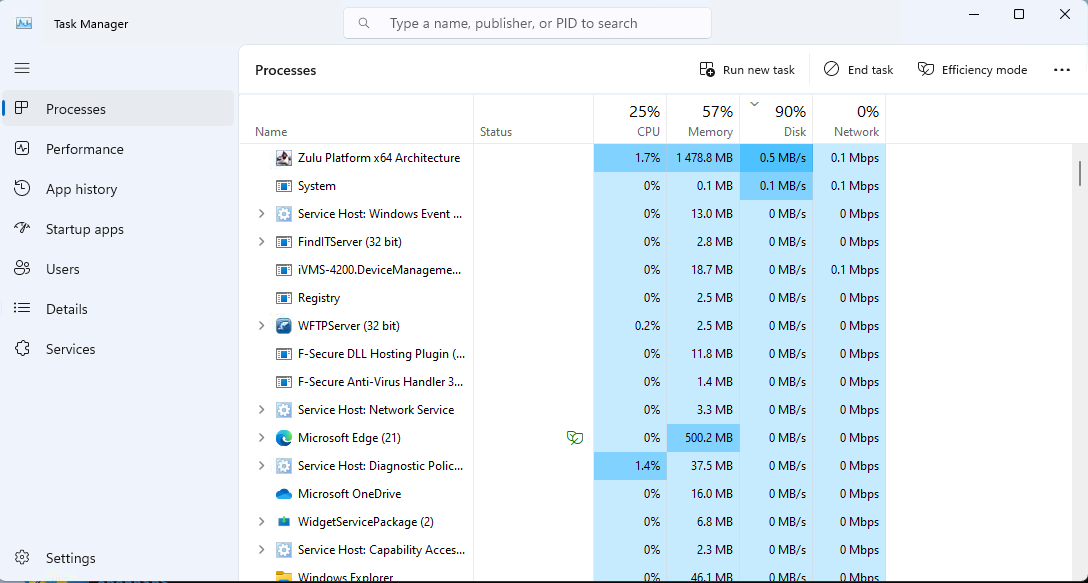

@splatch OK, thanks. Task manager shows quite high Disk utilization (see attached screen copies) so could this be the culprit?
As far I remember rrd pre-allocate its file upon first launch. This means that it does not grow over time. However - if your system uses virtual memory (so called swap) it might happen that copying of data from memory/to disk and from disk/to memory interferes with processes which try to read from it.
Take a look if your windows installation uses virtual memory and how. Its been a while since I used windows last time, so my knowledge on how it works nowadays might be rusted.

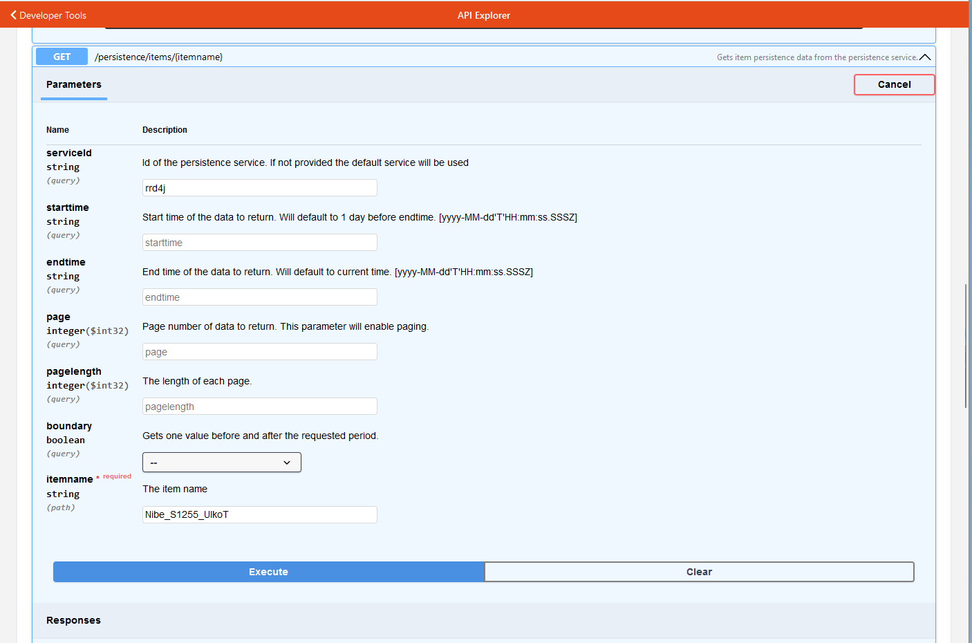

Navigate to Developer Tools → API Explorer → Persistence and query for some data and see how long it takes.
And there have been no relevant changes to rrd4j I know of that would account for this different between OH 3.4 and 4.1, let alone between 4.0 and 4.1. In fact, there was only one PR for rrd4j between 4.0 and 4.1 which fixed a problem with restoreOnStartup which added an additional condition to an if statement, not something that’s going to impact querying performance.

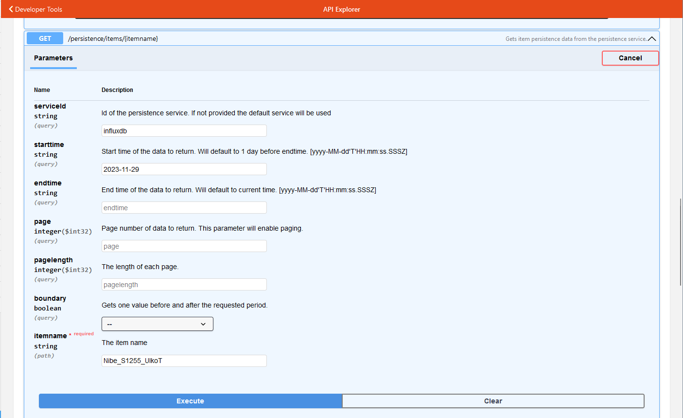

@rlkoshak, OK , now I understand what you mean. I made some tests (see attached screencopies).
In the first case (with rrd4j) there were 1440 data points and with InfluxDB 1467 points. When I tested rrd4j and kept pressing the Execute button the response was immediate but after ~5 trials the response was very slow so it took longer than ~10s.
With InfluxDB the response was always immediate regardless how many times I pressed Execute.

I think this last experiment is almost enough to file an issue. Put rrd4j and org.openhab.core.persistence (I think) into DEBUG or TRACE level logging and run the repeated queries against rrd4j again. See if you can find which parts seem to take longer between runs.
Gather those logs and description of what you did and file an issue on openhab-core or openhab-addons depending on where it appears the slowdown is occurring, which is what you need the logs for.
