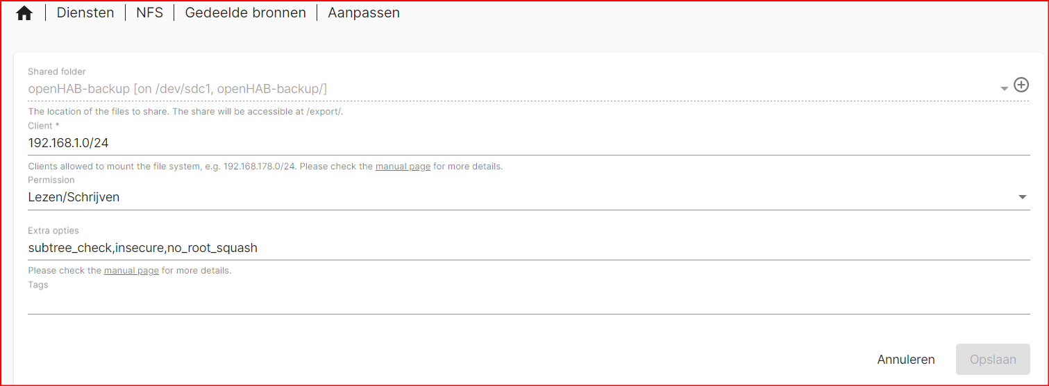

As far as I understand you try to write as user root ( sudo ).
How is the export defined for this mount ? Does it allow user root to write as user root from the client ?
Option no_root_squash in exports should allow this.
Do you want to write as user root or shall members of group users write to that directory ( do they have enough permission to read all files on the client ? ) ?
