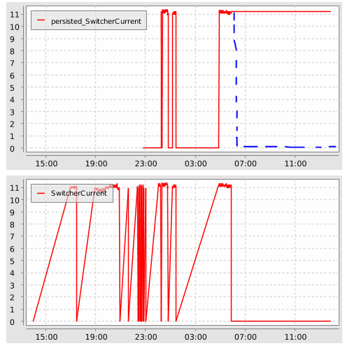

Here is what I am trying to achieve, the chart on the top is almost what I need.
The chart should show steps only, as the parameter is usually changing only in steps of 0 or 11.
It seems like the rule is “half” working, the second persist statement in the rule is not performed.

I could guess that you think the first chart has missed some reading altogether?

The really, really simple way to approximate your wanted pictures is to use both everyMinute and everyChange strategies on your Item, it’d pretty much do itself then.

I reckon you’d fetch previousState, then if and only if was zero (or close to zero) you’d add an “extra” persist of zero. Then fire a 1-second timer to persist the “real” new value, slightly delayed to make sure we don’t run into db timestamping granularity limitations.
Exactly the way I was thinking I need to do but my programming skill is very limited and I have no idea how to do that. This is the reason I went to the simplest way.
