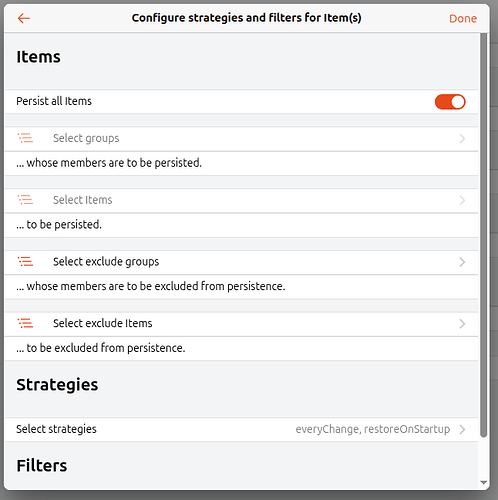

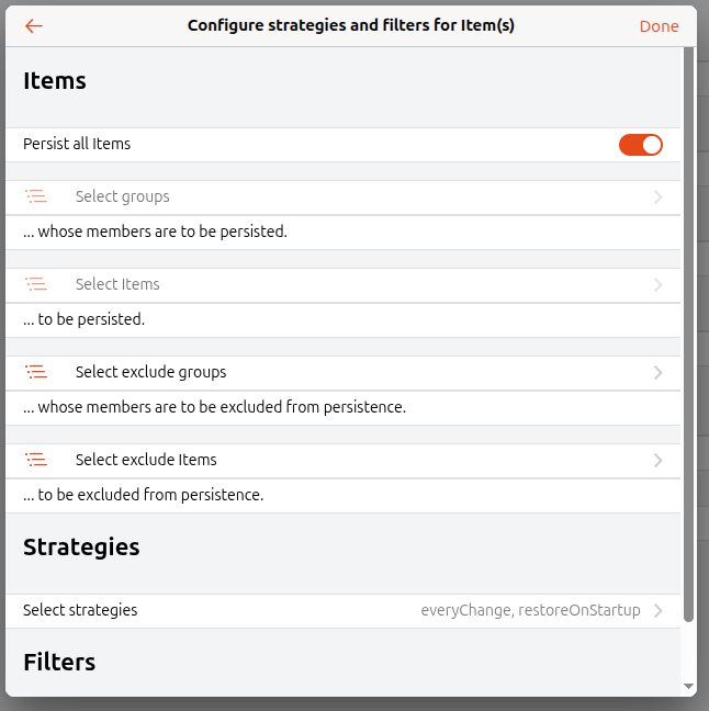

Do not read too much into that.
Consider this line in a .persist file
*: everyChange, restoreOnStartup
or this managed config:
configurations:
  - items:
    strategies:
      - everyChange
      - restoreOnStartup
    filters: []
aliases: {}
cronStrategies: []
thresholdFilters: []
timeFilters: []
equalsFilters: []
includeFilters: []
That’s an ā€œexplicit persistence configurationā€. Every Item, no matter when it’s created, gets persisted on everyChange and is restored on startup. Once set, this config never need to change again no matter how many Items were there before nor how many Items are crearted in the future.
Explicit config doesn’t mean each and every Item is mentioned in the persistence config individually. What it means is you must have a configuration in the frist place. The add-ons will not start doing stuff without a configuration like it does now.
