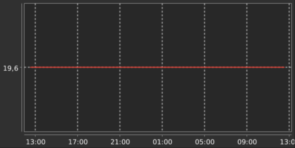

i just noticed that the charts for my three homematic thermostats current temperature stopped working.
The items still work fine and are showing the current temperature.
But the charts are stuck to an old value.

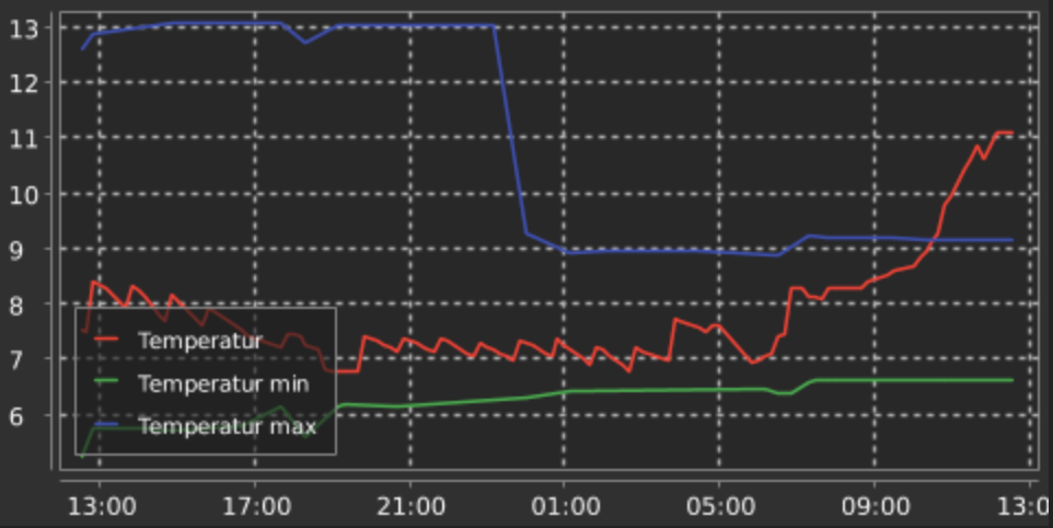

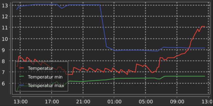

Working chart for weather items:

2018-12-21 12:36:06.071 [DEBUG] [thome.ui.internal.chart.ChartServlet] - Received incoming chart request: Request(GET //192.168.2.11:8080/chart?items=itmHeizung_Schlafzimmer_IST&period=D&theme=dark&t=1545392166040)@427f56
2018-12-21 12:36:06.077 [DEBUG] [thome.ui.internal.chart.ChartServlet] - No begin or end is specified, use now as end and now-period as begin.
2018-12-21 12:36:06.081 [DEBUG] [thome.ui.internal.chart.ChartServlet] - chart building with width 480 height 240 dpi null
2018-12-21 12:36:06.086 [DEBUG] [ltchartprovider.DefaultChartProvider] - Rendering chart: service: 'null', theme: 'dark', startTime: 'Thu Dec 20 12:36:06 CET 2018', endTime: 'Fri Dec 21 12:36:06 CET 2018', width: '480', height: '240', items: 'itmHeizung_Schlafzimmer_IST', groups: 'null', dpi: 'null', legend: 'null'
2018-12-21 12:36:06.094 [DEBUG] [sql.internal.MysqlPersistenceService] - mySQL query: item is itmHeizung_Schlafzimmer_IST
2018-12-21 12:36:06.100 [DEBUG] [sql.internal.MysqlPersistenceService] - mySQL: query:SELECT Time, Value FROM Item16 WHERE TIME<'2018-12-20 12:36:06' ORDER BY Time DESC LIMIT 0,1
2018-12-21 12:36:06.107 [DEBUG] [sql.internal.MysqlPersistenceService] - mySQL: query returned 1 rows in 6ms
2018-12-21 12:36:06.113 [DEBUG] [sql.internal.MysqlPersistenceService] - mySQL query: item is itmHeizung_Schlafzimmer_IST
2018-12-21 12:36:06.119 [DEBUG] [sql.internal.MysqlPersistenceService] - mySQL: query:SELECT Time, Value FROM Item16 WHERE TIME>'2018-12-20 12:36:06' AND TIME<'2018-12-21 12:36:06' ORDER BY Time ASC
2018-12-21 12:36:06.125 [DEBUG] [sql.internal.MysqlPersistenceService] - mySQL: query returned 0 rows in 6ms
2018-12-21 12:36:06.322 [DEBUG] [thome.ui.internal.chart.ChartServlet] - Chart successfully generated and written to the response.

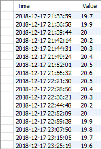

After checking the mysql server i noticed that openhab stopped writing persistence for these three homematic devices…
