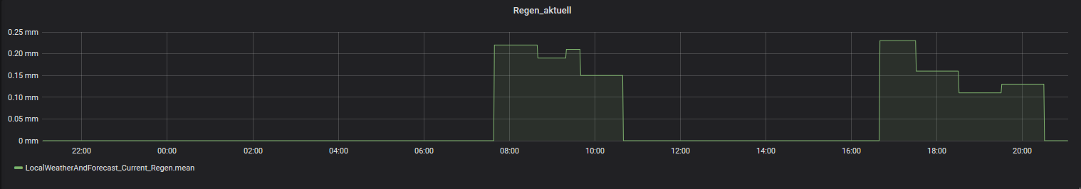

here the graph of the data (no sum)

Additionally how could the .72 mm value be correct, looking at your chart you have 8 different non-zero values, ranging from .1 to .22, and they sum up to .72???
Good point. The Grafana value is going to be wrong too - guessing this is data from OpenWeatherMap, it reports “Rain volume of the last hour”. Recording that 4 times an hour will give a 4x inflated ‘sum’ etc.

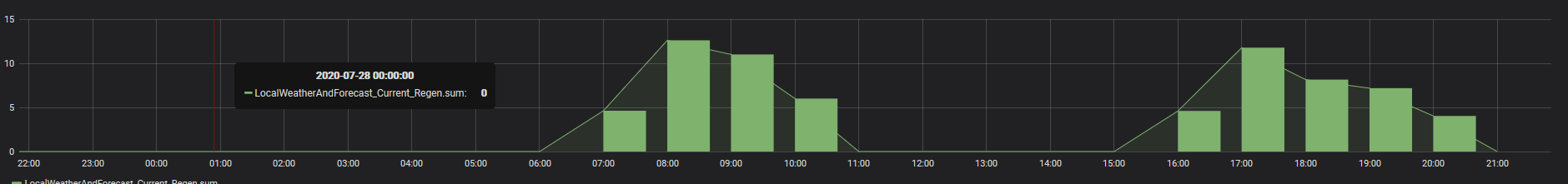

I have now grouped the graph in Grafana per hour. The sum of the bars gives about 69, the number from the rule but I don’t think this is the right way
