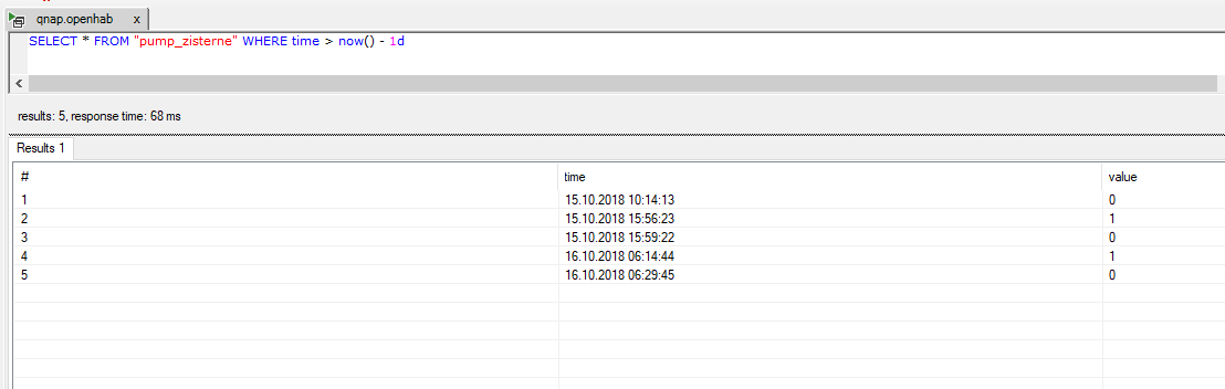

also with no binding an map, value in influxdb is numeric and not a string
Then you should be able to use sumSince
how can i debug, why its not working ? the request for query the items is sent to influxdb, i can read that in infliuxdb logs. the function it self is working anyhow, but returning “0”
