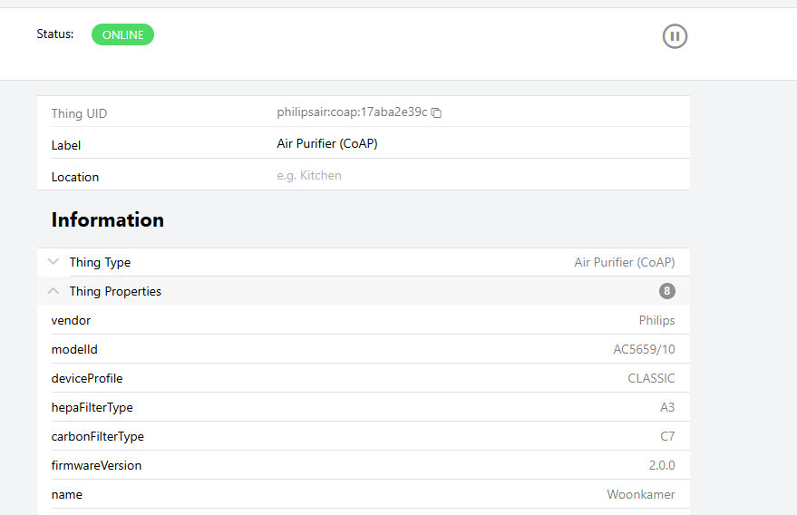

note: I had some challenges installing the latest, even though i installed via marketplace, it still picked up older version.
you can recognize if you have the newer when you see something about the profile in the log
11:16:26.858 [DEBUG] [philipsair.internal.PhilipsAirHandler] - Options of philipsair:coap:17aba2e39c: displayed index [StateOption [value=0, label=Allergen Index], StateOption [value=1, label=PM2.5], StateOption [value=2, label=Gas]], threshold [StateOption [value=1, label=Good], StateOption [value=4, label=Fair], StateOption [value=7, label=Poor], StateOption [value=10, label=Very poor]]
11:16:26.858 [DEBUG] [philipsair.internal.PhilipsAirHandler] - Profile of philipsair:coap:17aba2e39c: CLASSIC
alternatively expand thing properties and it should have “deviceProfile”

@Mclupo here is the version with the findings from your device incorporated. Not tested any further yet… trusting Claude to help out :wink:
no time at the moment to make a kar, but you should be able to drop this in the addon folder and get your model recognised and with the right commands.
https://verpaalen.com/openhab/org.openhab.binding.philipsair-5.3.0-SNAPSHOT.jar
Installing
  1. Uninstall the Philips Air binding if you installed it from the add-on store, or remove the old .jar / .kar from your addons folder.
  2. Copy org.openhab.binding.philipsair-5.3.0-SNAPSHOT.jar into the addons folder.
  3. Wait a minute or two for it to load. Your existing things can stay as they are.
The build is made for openHAB 5.3 (snapshot). Let me know which openHAB version you run if it does not load.
Testing the AC2939 (Wohnzimmer)
  1. Enable debug logging:
   log:set DEBUG org.openhab.binding.philipsair
  1. Open the thing and check that the property deviceProfile shows AC2939.
  2. Check that the mode channel now offers Auto, Gentle, Sleep and Turbo, and that it shows the right mode when you change it in the Philips app.
  3. Now set each of the four modes from openHAB and check that the device follows.
  4. Check that power and child lock still work from openHAB.
One known limitation: your device picks the fan speed itself per mode, so the `fan-speed` channel only shows the speed. Setting it from openHAB will probably do nothing.
Testing the AC0950 (Schlafzimmer)
  1. Check that the property deviceProfile shows AC0950.
2. Set the mode (Auto, Sleep) and a fan speed from openHAB and check that the device follows.
  1. If your device has them, try the timer, beep and display brightness channels as well.
What to report back
  • Which of the steps above worked and which did not.
  • For anything that did not work: the debug log lines from that attempt, especially the Sending command ... line and the Status from ... line that follows it.
You can switch the logging back afterwards:
log:set INFO org.openhab.binding.philipsair
Every thing perfect - thanks a million
Testing AC 0950
  1. Auto → indicates Auto Speed = 1 selectable from openhab item “mode”
  2. Sleep → indicates Sleep Speed = 1 selectable from openhab item “mode”
  3. gentle → indicates M Speed = Medium NO SELECTABLE from item “mode”
  4. Turbo → ino change in item Spped = Turbo NO SELECTABLE from item “mode”
child lock is OK
openhab MODE shows only Auto and Sleep
