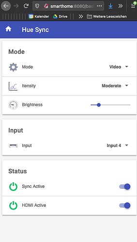

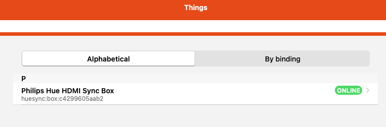

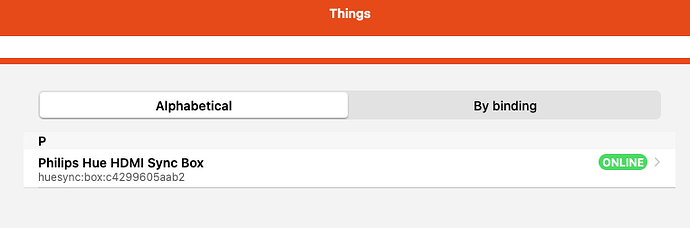

Some screenshots:
Oh.. perfect!! I already love you!
I would love to participate and support you in any way! :slight_smile:

Hey :slight_smile:
You are right about the IP. First in autodiscovery i got the right hostname. When pairing didnt work changed it to the ip, but i guess that DNS worked before (i also checked if the hostname was right) and i think that wasn’t the issue.. pairing did also not function with the ip in the config and just after pressing the button longer it worked.
One question, if you did this a lot of times: Does the green light flash once or many times in pairing mode? For me if i press the button 3s it just flashes green once.
About input and output channels, yes they already exist, that is nice.. my suggestion was, to pack them to the “advanced tab” in the mainui thing configuration. That is nothing i need in any way, but maybe it’s nice for more casual users of OH3 :slight_smile:
How it is:
How Hue binding displays the channels:
About passthrough:
It probably also works fine for me, i have to test it a lil bit more when Switches work now :slight_smile:
I guess i’m also using it just to Power/Sync On/Off and switch input devices.. so its totally fine!
Thank you again!
If you have anything i should check or thest, i’m always up to it. Just send me a message here or as PM (german is also okay for me :wink: )
Greetings,
Jay
Just adding - installed the file and works like a charm for now. Thank You, great work!
First let me say that I installed originally on a Rasperry and the app was awesome; excellent job! But then I installed OH in a Docker and when I reinstalled the Sync Box Binding it would not receive the API Key. Nothing I did would work. I see at the top: API Error: java.net.UnknownHostException: huesyncbox-c42996057924. I should add that I copied and pasted the API Key from the Raspberry to the Docker Binding.
I’m guessing that mean my java in the container is not up to snuff; true?? How do I upgrade it if that is indeed the problem?? Thanks

The API authorization process seems broken with the newest update. You can use this link for API instructions or just follow my steps underneath. Hue Sync Box support? · Issue #552 · ebaauw/homebridge-hue · GitHub
How to fix this:
First, install the addon, autodiscover your syncbox and maybe change its Thing-Configuration to its real numeric IP (e.g. 192.x.x.x) and then follow these steps:
  1. Get your SyncBox IP
  2. download Postman (www.postman.com) (This is an easy API Tool)
  3. open Postman an do a POST API request to this URL: https://syncboxIP/api/v1/registrations
  4. You should get this response: { "code": 10, "message": "No payload" }
  5. Click on raw and on the most right site choose JSON
  6. Enter this into the body: { "appName": "openHAB", "appSecret": "MDAwMTExMDAwMTExMDAwMTExMDAwMTExMDAwMTExMDA=", "instanceName": "openhabian" }
  7. Press SEND
  8. You should get this responce: { "code": 16, "message": "Invalid State" }
  9. Press the Button on the SyncBox (3 seconds) until the light flashes green once
  10. Redo STEP 7
  11. You should get a response containing your Hue Sync Access API Token
Paste this new token without the “” into your Thing Configuration. You might need to click Show advanced first.
Your openHAB should now connect flawless to your syncbox and will stay ONLINE.
