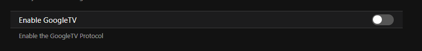

I did quickly double check in my system and have re-added the PhilipsTV-Thing:
  • It should be OK to add PhilipsTV and do Pin-Process with this Setting:
For GoogleTV you don’t need to do the pin process separately.
