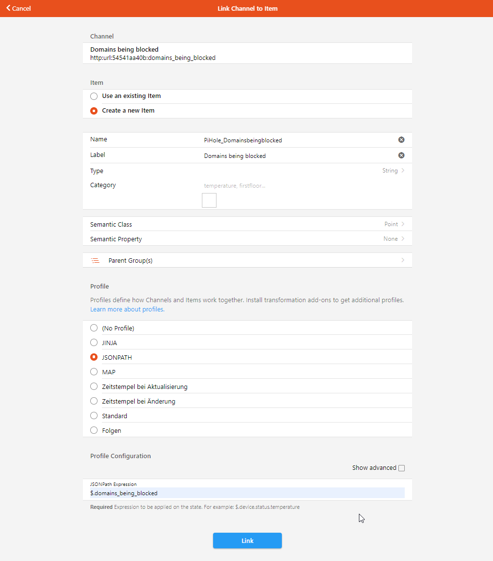

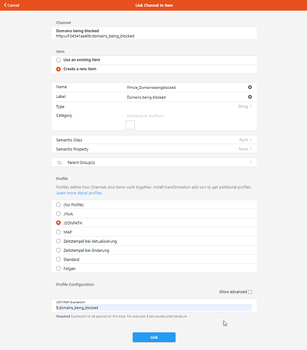

And adding an Item looks like this:

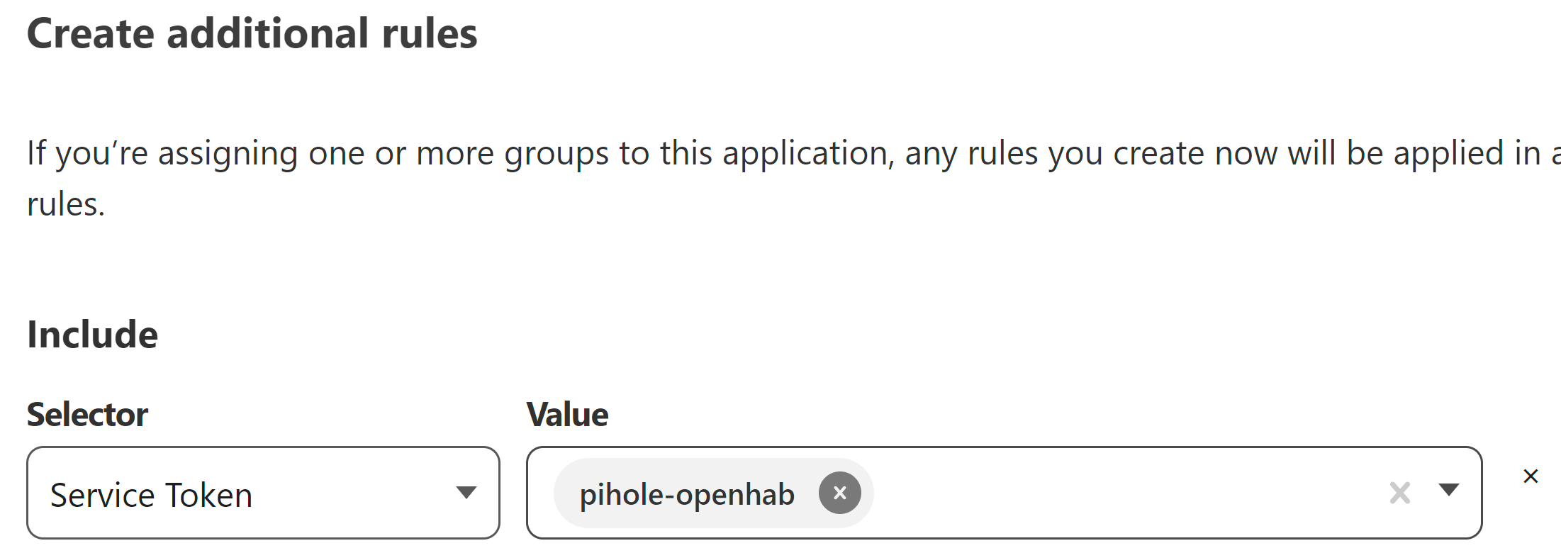

For those, who are interested in accessing a pihole instance which is behind cloudflare access, please check out my comment on that topic:
