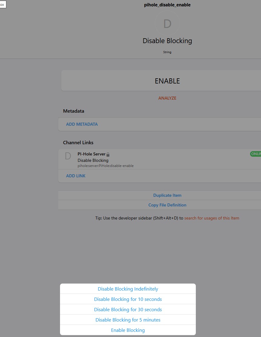

You have to switch the Pihole_Server_Status to OFF to disable blocking.
Pihole_Server_Disable_Blocking is a ‘shortcut’ that let’s you access directly some actions. See here
Hmmm I tried that but that did not work. Also the documentation states that the channel is read only.
My item “PiHole Server Status” is connected to the channel “Status”
I tried again tonight but I cannot disable blocking through this channel. Are you sure that this is working for you?
It works for me too
Yes the disable-enable channel works for me too. But the enabled switch channel does only work in read only mode. Switching it off will not switch off the blocking mode on the pihole.

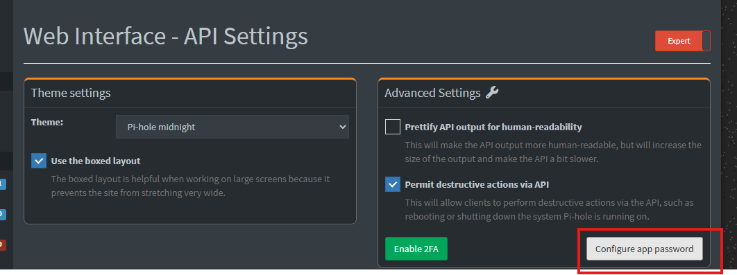

In the Pi-hole settings go to Web Interface/API
Display Expert settings then click on Configure app password
I think there may be a typo and it should say API password.
The docs on the main branch have been updated, so with the next release, the official docs will also be updated:
