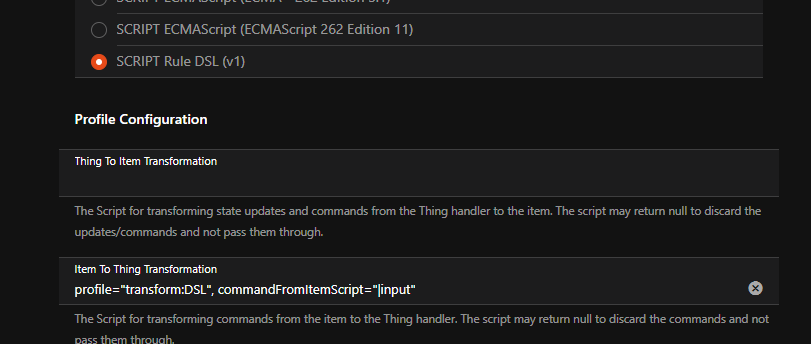

So as a “trick”, you can add a profile in your player item to channel link. This one would work: profile="transform:DSL", commandFromItemScript="|input"
That converts the PlayPause command to a String which the mqtt will accept.
We should probably relax the requirement for the string channel so it could receive stuff like this though.
added that profile to the channel
Got an error in the events log
09:30:35.282 [ERROR] [n.module.script.profile.ScriptProfile] - Failed to process script ‘profile=“transform:DSL”, commandFromItemScript=“|input”’: Could not get script for UID ‘profile=“transform:DSL”, commandFromItemScript=“|input”’.
In the “itemtothingtransformation” option, you’d just type |input. I’m not sure if this works in openhab 4.1 but give it a try
yup, that worked!
