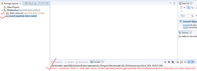

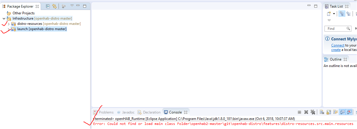

which are the below i need to select for openhab2 development
the below screenshot show you the downloaded packages and error while run
It depends on what you want to develop.
For an openHAB2 Binding, select “openHAB2 Add-ons”
If you want to contribute to the Z-Wave Binding, select “openHAB Z-Wave Binding”
If You want to contribute to the core, select "ESH + OH2 Core Bundles.
Not so difficult …
The error indicate that You have not choosen the correct development packages.
