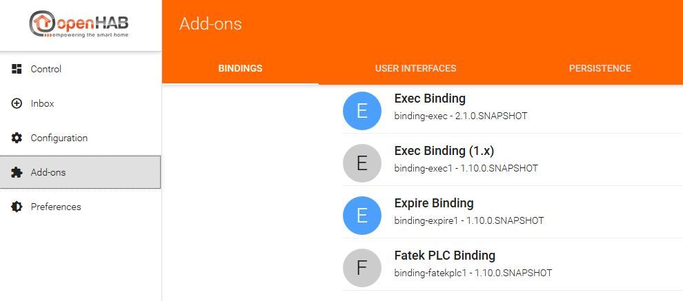

https://openhab.ci.cloudbees.com/job/openHAB1-Addons/lastBuild/org.openhab.binding%24org.openhab.binding.expire/
… or install it via PaperUI
To see the 1.x bindings you need to activate Configuration → System → Include 1.x Legacy Bindings.
Thank you thank you :slight_smile: I am on 1.8.3 (and thought the PaperUI is only for OH2??)
Arghhh, yes, now I remember :grinning:
Time to switch! It only hurts for a couple of hours …
