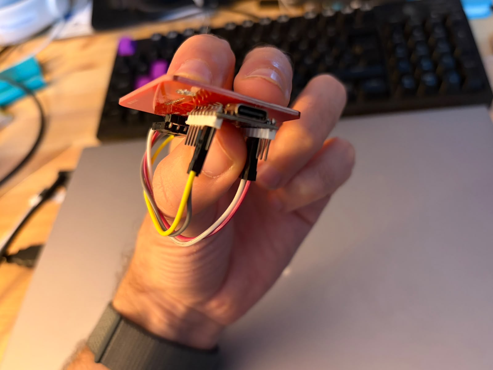

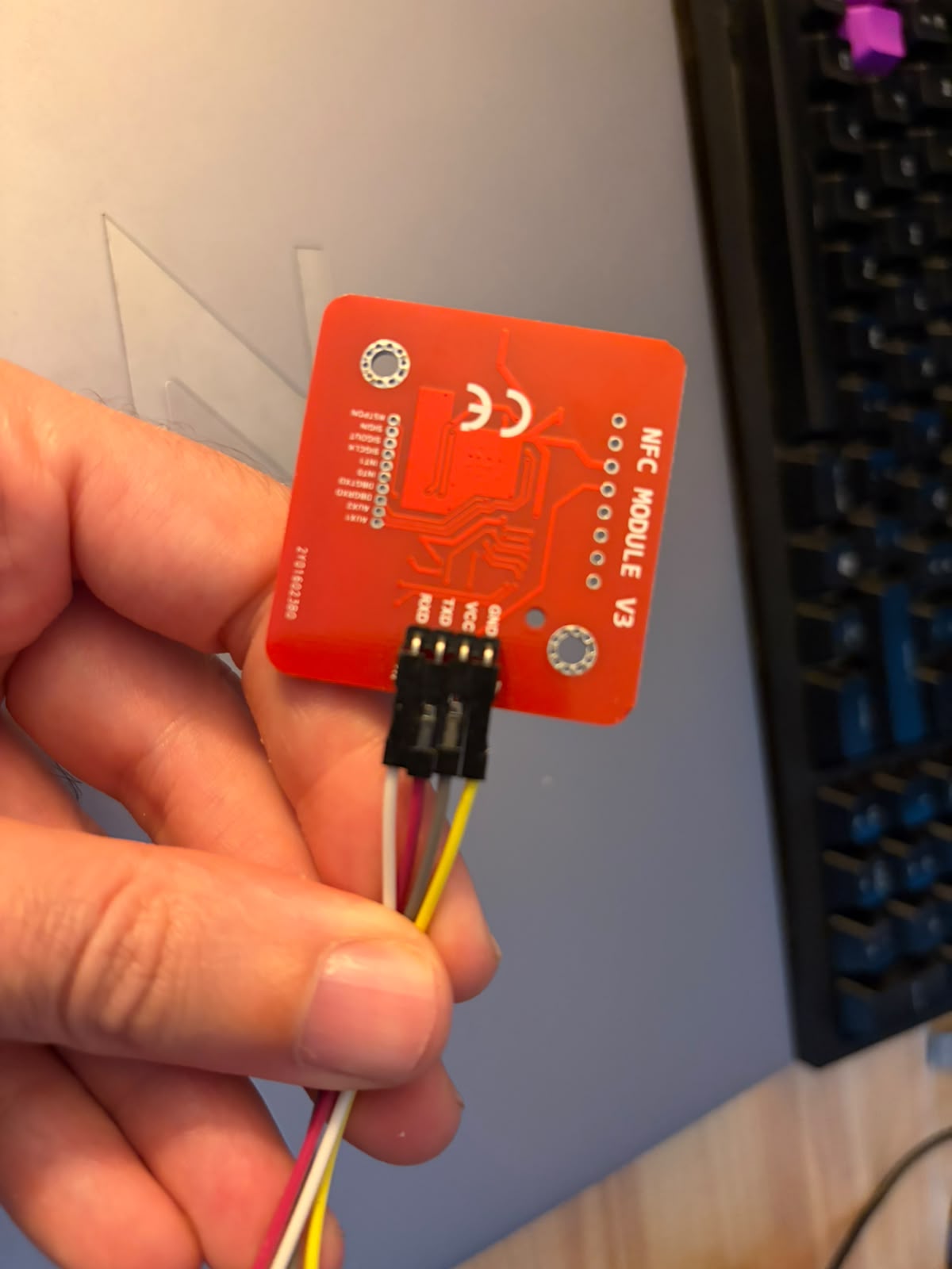

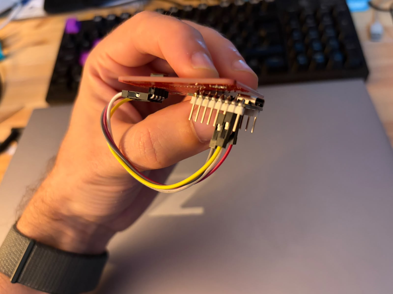

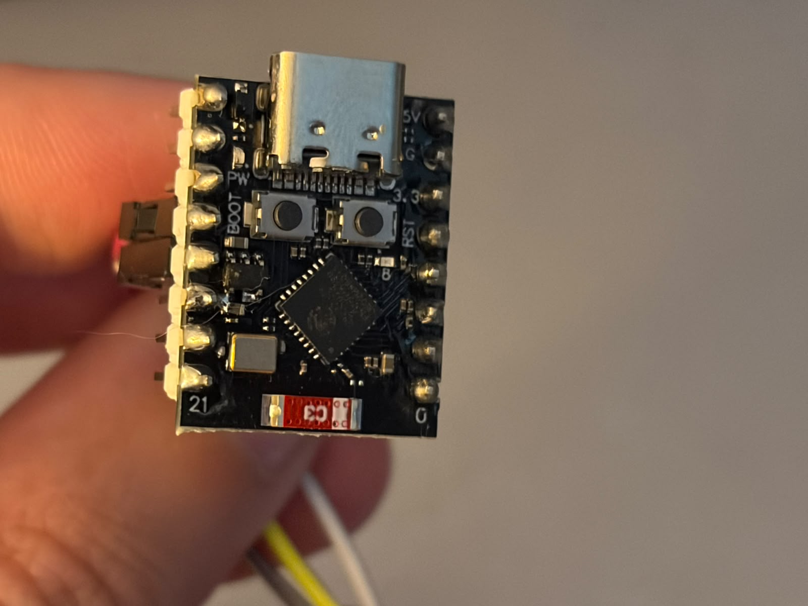

Might as well share the hardware:
Esp32-c3
NFC card reader (i2c)
In time I will design a 3d printed enclosure and store everything neatly in the front of the Besta (IKEA) TV bench, so my kid can grab the nfc cards (on which I will stick the pictures of his favorite characters) and scan them with the nfc reader.
