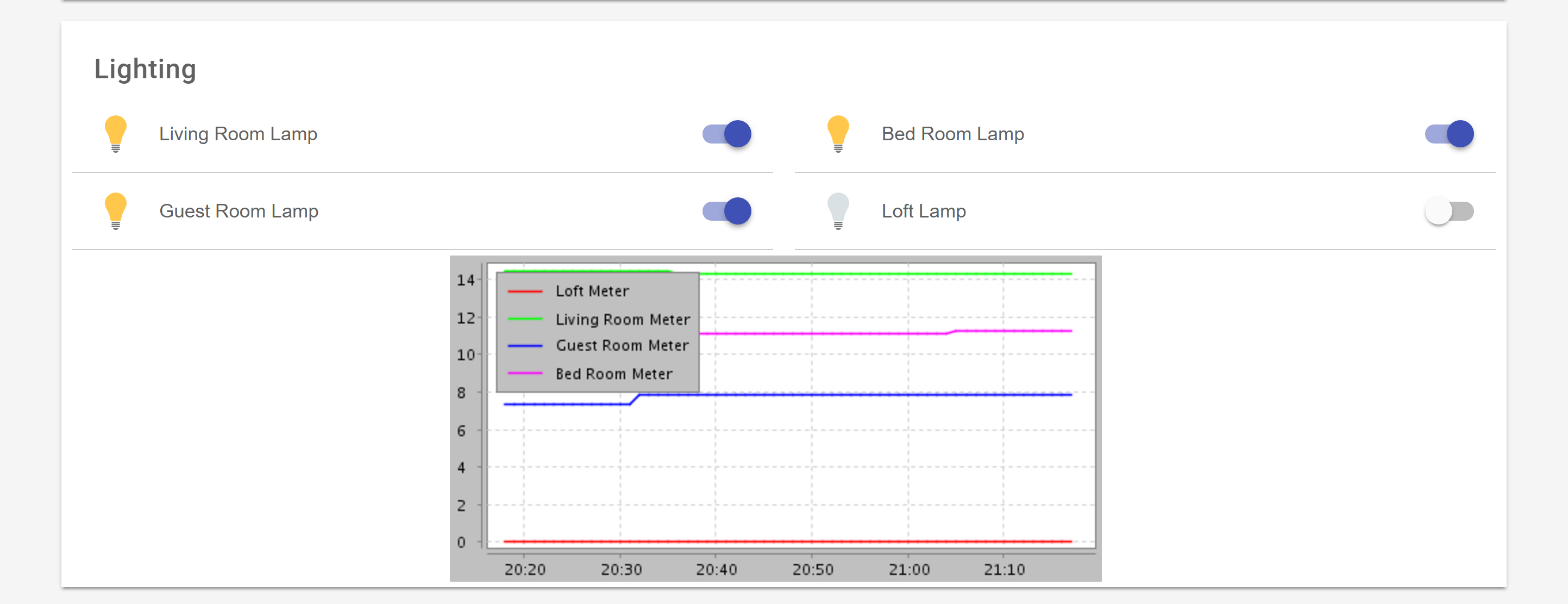

I’m trying to set up a group to chart that group (i’ve had success graphing one item!).
So i’m trying to graph all my Electricity meters, so have created a group gMeters

Well! Restarting openHab fixed it an everything is running as expected. Wierd
You might be interested in the Group SUM feature. You’d have to persist the Group for charting I think.
I’ve got it all working the group is now persisted and charting, was looking to chart all items separately, but thanks for the heads up.
Not sure why openhab freaked out but a restart fixed it
