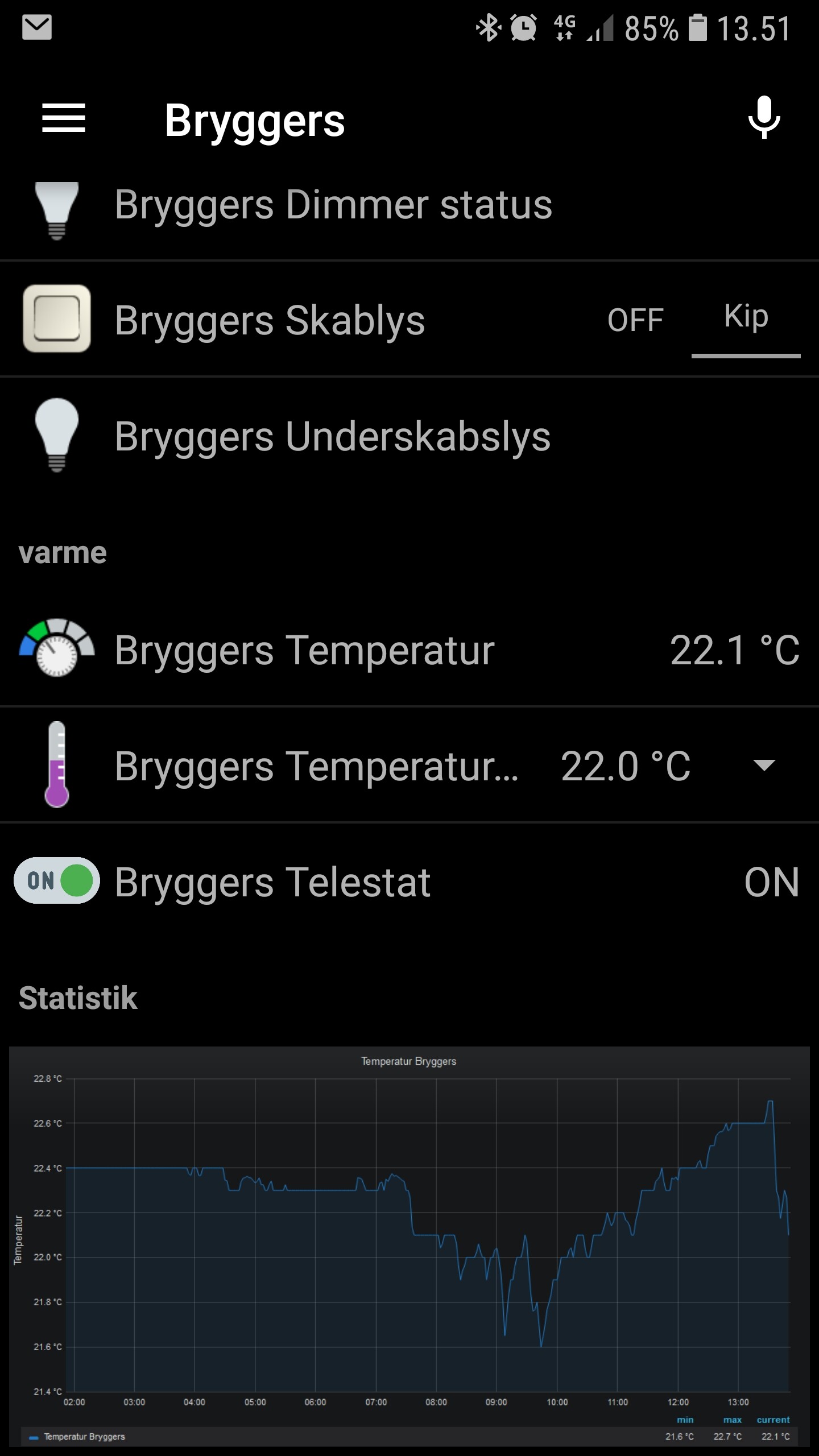

Both options works fine remote through the openhab android app, as well as myopenhab.org, on my system though, (beside rendering sucks and takes a huge amount of resources).

You´ll not be able to use Webview and myopnehab.org for a local Grafana server. Webview doesnt proxy the Ip adresse. Which means, when you use Webview and a local server, the client tries to locate the local IP when beeing remote.
You have to add remote access to your Grafana server (not a good idea) using portforward.
Or you have to use rendering (Image type) in your sitemap. Image (rendering) works fine by remote access. But Image type (rendering) uses a huge amount of resources on the platform you run Grafana. I had to stop Grafana on my Rpi and move it to my windows server (more powerfull PC), to be able to use rendering.
This is how it works remote (android openhab app) when using image type in a sitemap:
