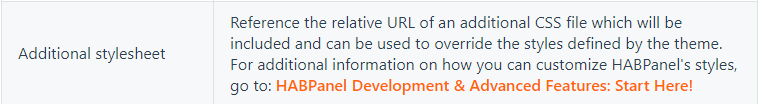

I don’t know about full themes, but you can reference an external CSS file in the HabPanel settings if you just want to change some of the colours. See “Additional features and settings”.
Yes,
I also found these instruction and information ,
but is there a simple example how to change “simple” the defined colors from a provided theme?
I have only very basic css knowledge, so i.e. I don’t know the css “variable name” to overwrite in the my additional stylesheet.
