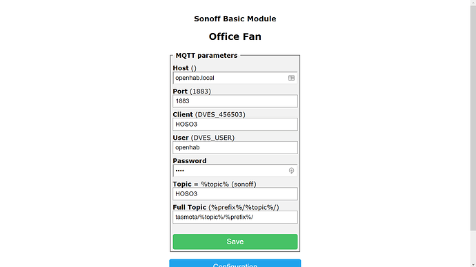

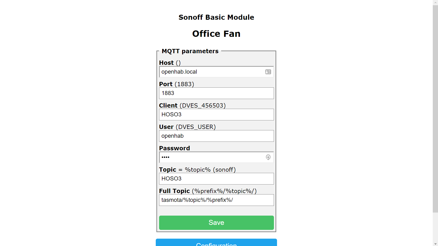

I have my linux based OH system advertising itself as openhab.local using the default avahi-daemon config as its hostname is set as openhab.
I then use ā€˜openhab.local’ as the MQTT hostname in the sonoff modules configuration and they discovery the Openhab server IP address dynamically.
