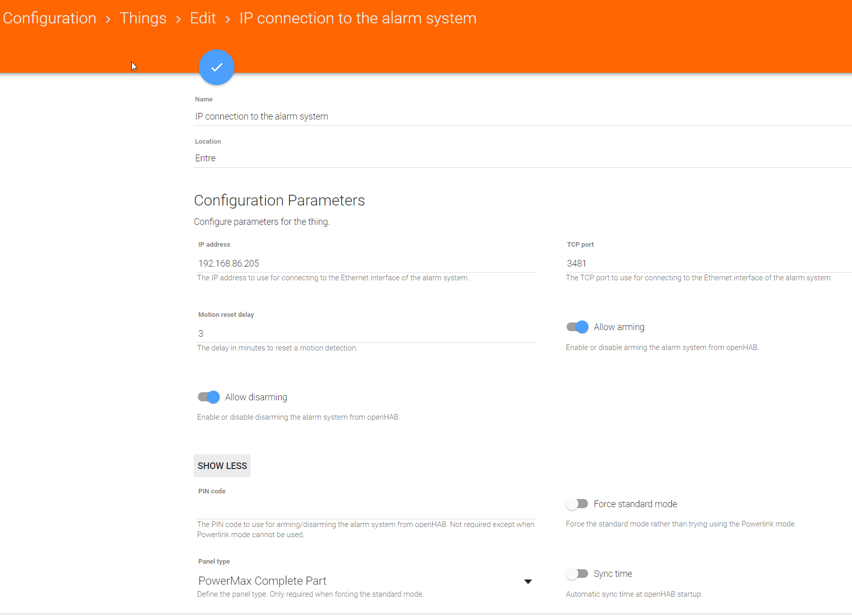

@Lolodomo: I’m testing the 2.1.0 snapshot without success. download_setup fails with:
2017-09-13 14:37:03.416 [INFO ] [wermax.handler.PowermaxBridgeHandler] - Powermax alarm binding: download setup only supported in Powerlink mode
My setup is using the “IP connection to the alarm system” in the following hardware setup
Powermax RS232 Kit for UC232R-10 ser2net on Openhab 2.1.0 on
Complete <--> Powermax Pro & Complete <--> USB/RS232 <--> OpenWRT <--> Openhabian
Converter NSLU2 Raspberry Pi3
This setup works with the 1.10.0 powermax binding (and was previously used with a Vera3 on UI5 and the Mios Powermax plugin in powerlink mode)
The 1.10.0 version has been uninstalled and Openhab2 restarted and the 2.1.0 snapshot version dropped in the addons folder
From the logs I assume the connections kind of work (Also the Panel has stopped calling my mobile with “Tamper alerts” - So the communications seems to be restored with the new binding) - But not in powerlink mode:
@hhg : the message “Powermax alarm binding: download setup only supported in Powerlink mode” should only appear because you requested this download either through the console command or the dedicated item. Can you confirm that this is the result of one of your actions ?
Apparently, the powerlink mode is not activated by the binding in your case.
Please enable the DEBUG logs: log:set DEBUG org.openhab.binding.powermax and use the 2.2 version I provided.
