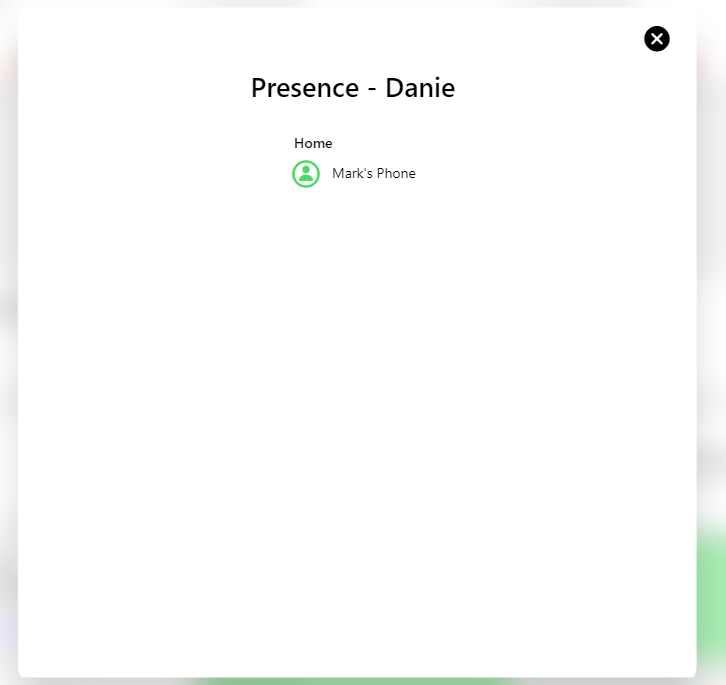

This is not exactly what you are trying to do I don’t think, but this is what I did when I was trying out Presence:
This is a popup from the Overview page. You can add the below YAML as the code for a cell off the Overview page.

Hope it gives you a place to start
Hmmm… I’ll try this out. But I thought the point of using that metadata was that it would be easy to then just add it to a page? Still trying to puzzle together all this…
This is a list Item widget, right and you’ve set it as the “default list item widget” for the Item, right? Anywhere that Item is shown in the UI as part of a list card (e.g. the overview tabs) this widget will be used.
