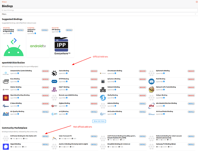

So I am still a bit confused. I am currently running OH 4.3.2. I installed the Insteon Binding from the Add-ons from the OH main web page. I thought this was the “official” Insteon binding for my version of OH. So what is this beta binding: Insteon Binding (Beta) [4.1.0.0;4.3.0.0) Is this the “beta” of the binding I am using or is this a
n entirely different binding from a different developer? And where is the addons folder you mentioned.
If you installed it from the “openHAB Distribution” it’s an officially maintained add-on that is part of the OH project.
If you install if from “Community Marketplace” it’s a bind that is not a part of the openHAB project. It’s likely an add-on written by one developer and it’s not affiliated with the openHAB project. Often developers will post a testing version of an add-on to the marketplace first before submitting it to the openHAB project to become official.
That’s a marketplace add-on which can only be installed on openHAB versions 4.1.0 through 4.3.0. It is not an official add-on. Though it does look like a testing version of the add-on so what ever changes were made and tested there may have become a part of the official binding.
You need to read the posting to see what that binding is (testing, completely different binding, etc) and the version numbering in the post title indicates what version of OH that add-on will work with.
