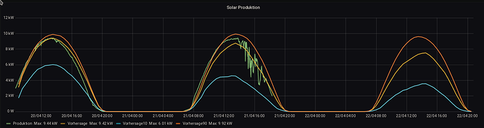

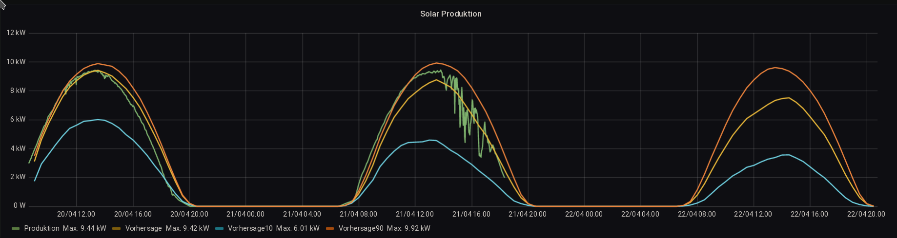

component: widget:Grafana chart with timeranges
  URL: http://192.168.1.210:3000/d-solo/mgJqv2lGz/solar?orgId=1&now-{period}&to=now%2B56h&theme=dark&panelId=6
  height: "400"
  timerange: 1d=1 day,3d=3 day,7d=7 day
