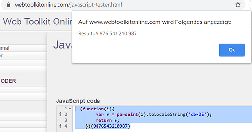

Question: I would like to format the result to local number-format (e.g. “1.234,56 MBit”)
I tried different versions of the corresponding JS-functions and checked it on
but in openHAB nothing worked.
Any idea?
Solutions I tried (division by 1024 omited):
(function(i){
var r = parseInt(i).toLocaleString('de-DE');
return r;
})(input)
(function(i){
const toMBit = new Intl.NumberFormat('de-DE');
var r = toMBit.format(parseInt(i));
return r;
})(input)
