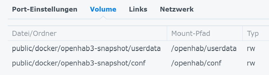

From the Synology UI i choose the image i want to use, and add ‘Volumes’ on my host for backup reasons and the ease to access config files (was doing textual configuration in OH2 and now partly also in OH3). From my understanding the ‘Volumes’ in Synology UI are nothing else but bind mounts, right?
My problem always has been that i was not able to really use the addons folder, hence it is missing in the screenshot.
Either files i saved on the host in that folder never appeared when i checked inside the container, or after i created the folder ‘addons’ via putty with the respective uid/gid and rights the files appeared but didn’t take the correct ownership or rights.
