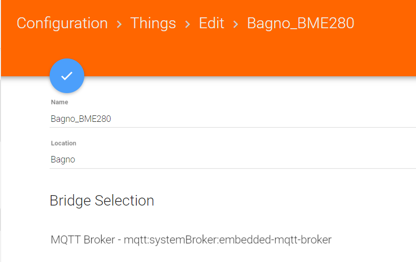

I have an esp8266 with a temperature sensor. I use MQTT to send temperature data to openhab MQTT service (Broker). With paper UI I configure Things,Channels and Items. All work very well and I can see in paper UI control the right values. Then I install open Hab cloud service and configure one account. I see my openhab online and I can access it. I configure Alexa skill and give it access to myopenhab. Then I find a guide and I try to add tag using REST api to the temperature Items, then I try to discover devices with Alexa. No way, I reboot openhab and try again. Then I find documentation for Alexa with V3 metadata. So I delete from paper UI the item and I try to create a new item configuration file in $OPENHAB_CONF/items
After create the Items file, with paper UI I link the item in the thing channel

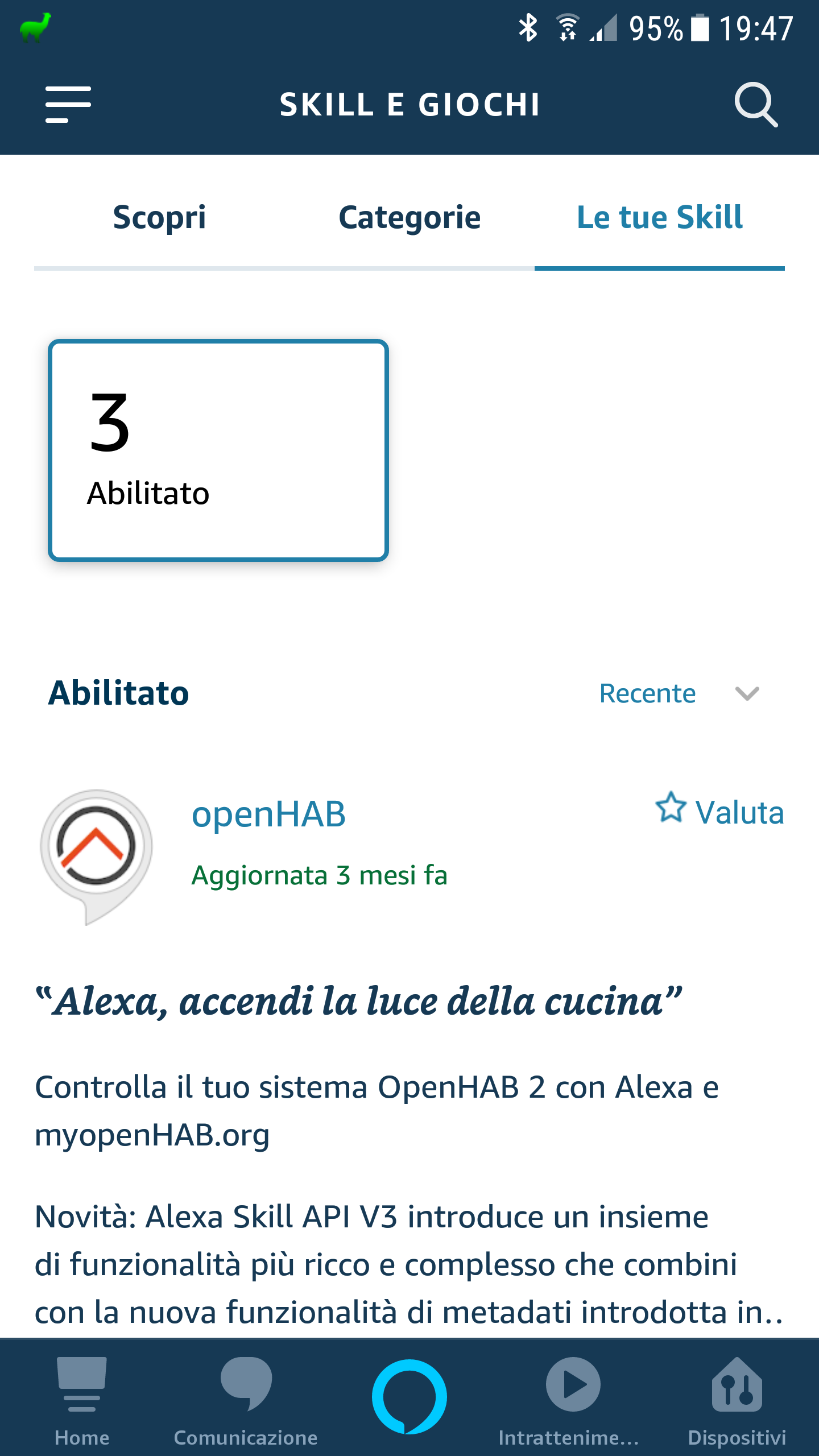

I have Alexa skill installed and enabled. I can see it in myOpenHAB.

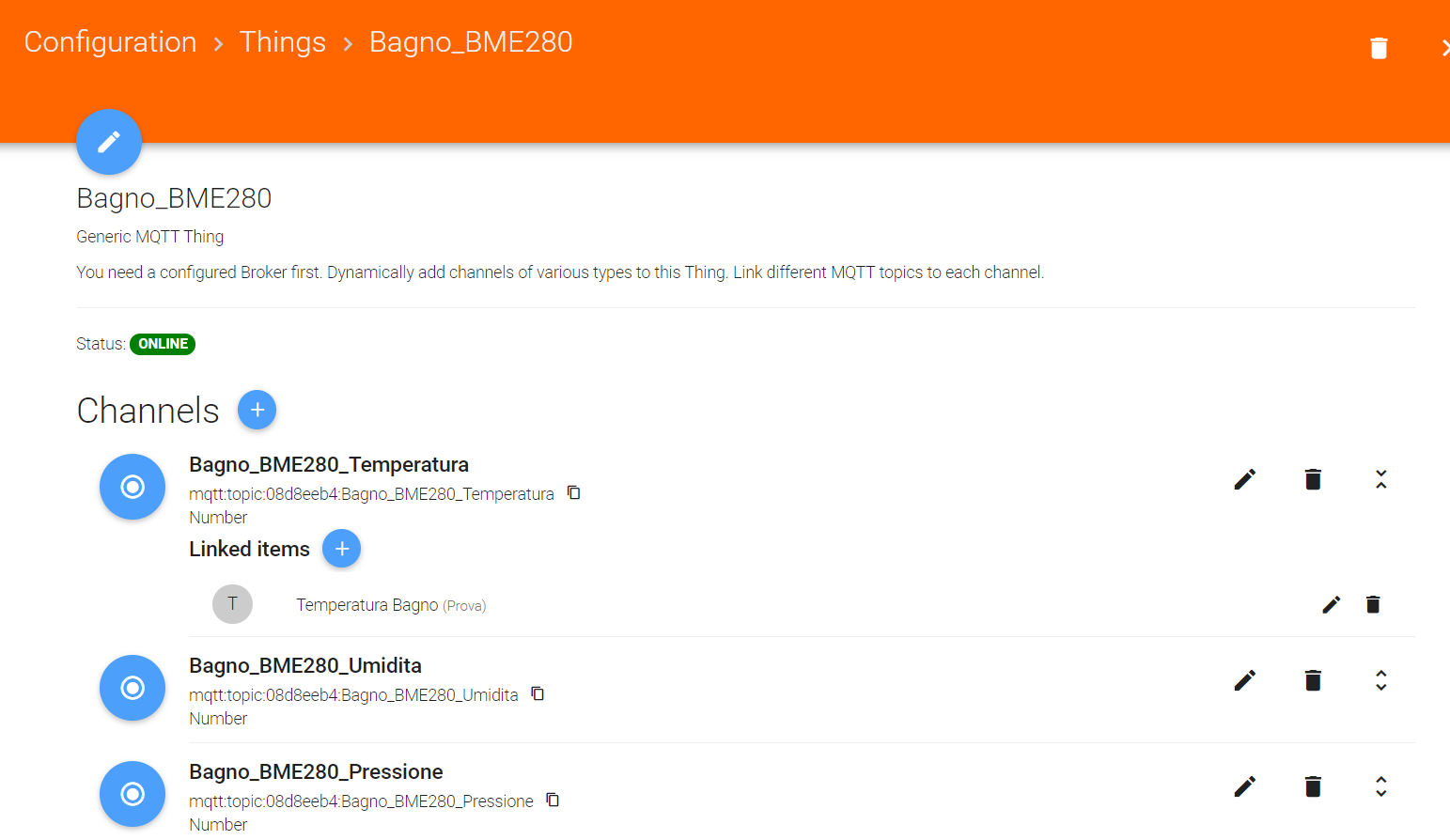

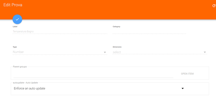

Then I try to create a new temperature item. I want to check if linking channel with the item let Alexa find it.
I can’t link item to my Things with web page. When I try I can’t find them in the channel configuration with system:default profile. I can see them only with the follow profile (I can’t understand why…)
So I use this code to link channel in my Items file
Then I scan for devices in Alexa APP and I find it.
