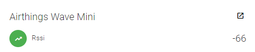

After that, I got a connection to my sensor on the PaperUI where I can control the RSSI. So, it’s working and the connection is there. But openHAB doesn’t get the information from the sensor. I searched for the problem and found out that I have to use version 5.43-5.47 for BlueZ instead of 5.50 (That was my first try some weeks before). So, I look in the procedure again but recognized that I installed version 5.43.

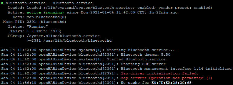

My second problem is that I get some errors when I type “sudo systemctl status bluetooth”:
Dec 23 20:22:57 openHABianDevice bluetoothd[855]: Sap driver initialization failed.
Dec 23 20:22:57 openHABianDevice bluetoothd[855]: sap-server: Operation not permitted (1)
Dec 23 20:22:57 openHABianDevice bluetoothd[855]: Failed to set privacy: Rejected (0x0b)
I tried to search for a solution but I couldn’t find any good exact information about the problem. I really don’t know what the sap driver do and why I need him.
Second question: Why does it happen? If I get installed version 5.43, would the problem still be there and how can I solve it?
I get the following result:

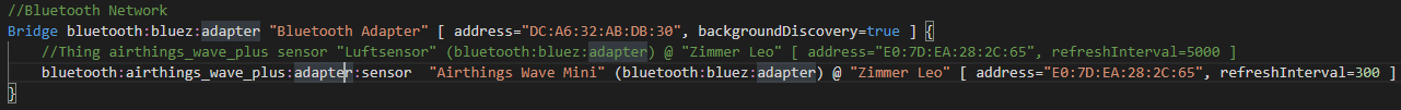

In VS Code, I installed the Thing & Bridge for my Airthings Wave Mini.

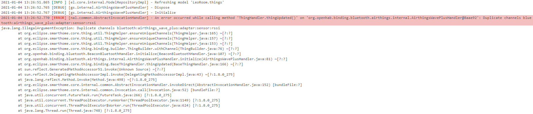

When I update the File, I get an error in my Log Viewer:

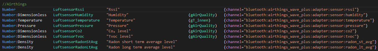

I really don’t know what the issue is. My .items File for my Airthings sensor looks like this:
This looks like a bug to me - please enter an issue at GitHub · Where software is built and provide this log in it. Thanks!
The RSSI Thing is working fine which means that the connection is there.
This is good news, because it seems that the above bug does not have a negative impact on the functionality.
