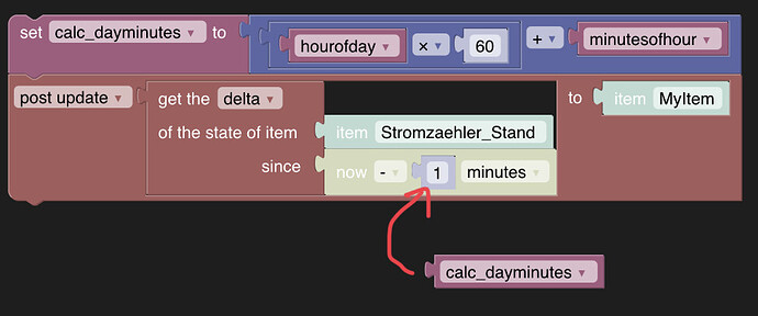

I try to calculate some statistical values for variable time differences in a blockly rule. I calculate in a block the time difference and store the value in a variable, but i recognized that it is not possible to link this variable to the number input Field of the statistical value block (now - number value). Actually in my point of view there is only a determination with static values (fixed time differences) possible or is there something I don‘t see….?
Thank you for your help!
It seems there’s some kind of bug with the “shadow” block…
What you can do is drag a “real” block from the openHAB > Persistence category to replace the “shadow” one, and then you can drag your variable block into it.
Thank you, this did the trick. Good to know that you had the same problem:-)
